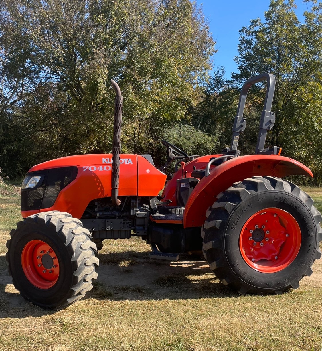

you should be able to pick up a 60-70 hp M kubota pre 2014 (no emissions) in your range.
I got this one on the low end of your budget a week ago. 2wd should be very easy to find a nice one on your range.
