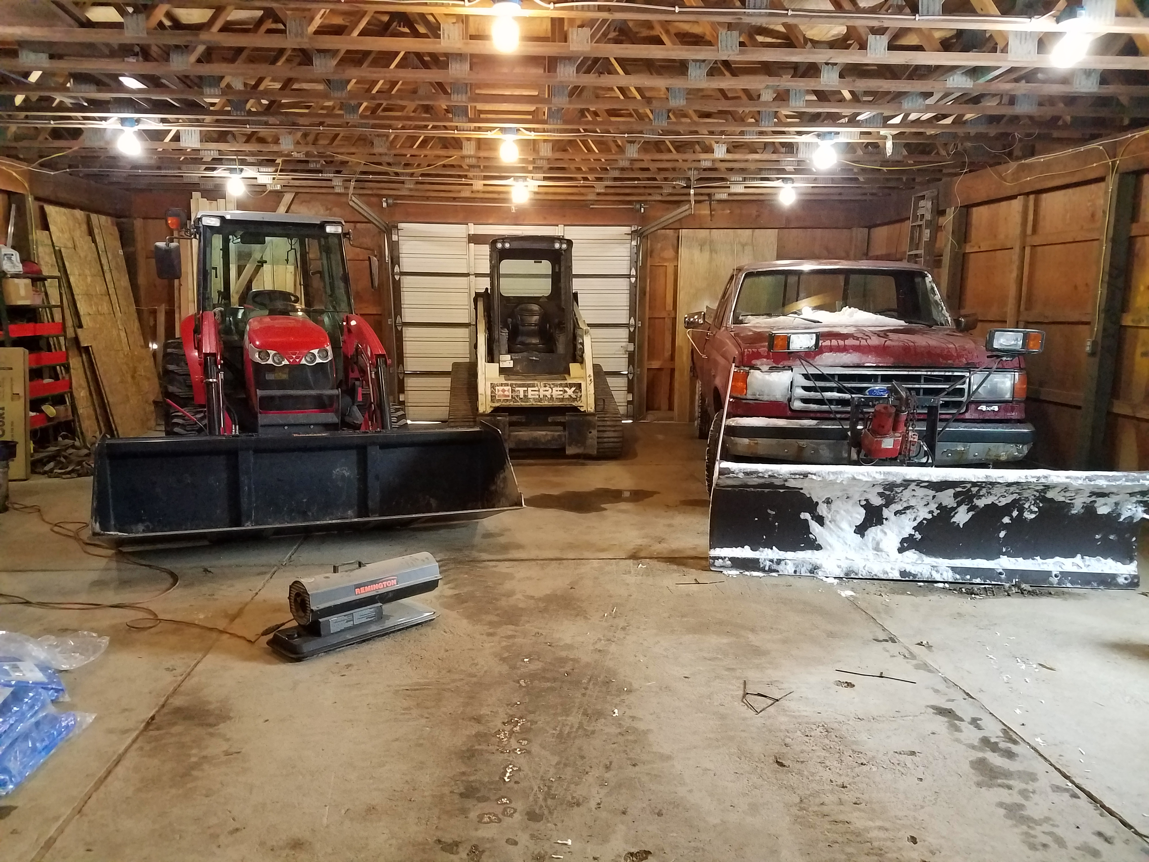

This is my first year with a plow truck. Previously, I always plowed with tractors. In the pic below, you can see my F250 plow truck, as well as my Massey 1652 with 8' hydraulic back blade and 90" front bucket.
For doing straight passes on my 1/4 mile driveway, my neighborhood, and wide open areas... the plow truck beats the tractor, hands down, no competition. You can move faster and throw (windrow with force) the snow much better.
Doing tight work in front of the garage, barn, etc... The tractor is better.
You could fit a homeowner grade plow on the front of your truck, new for around $2500. But like others have said, that's alot of abuse for that truck.
You could also shop around for an old beat up plow truck like I did... For less money than installing a plow on your truck.
