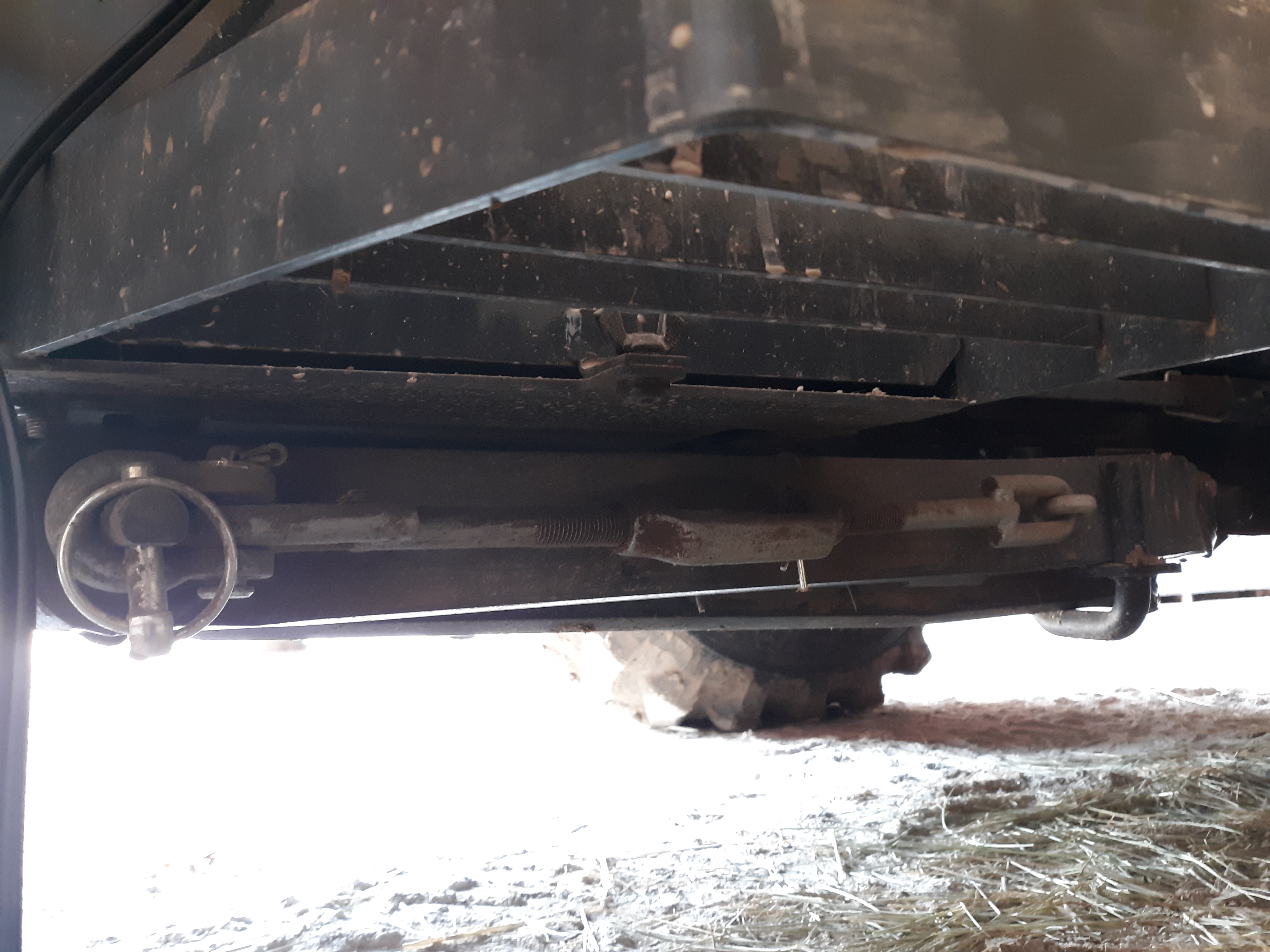

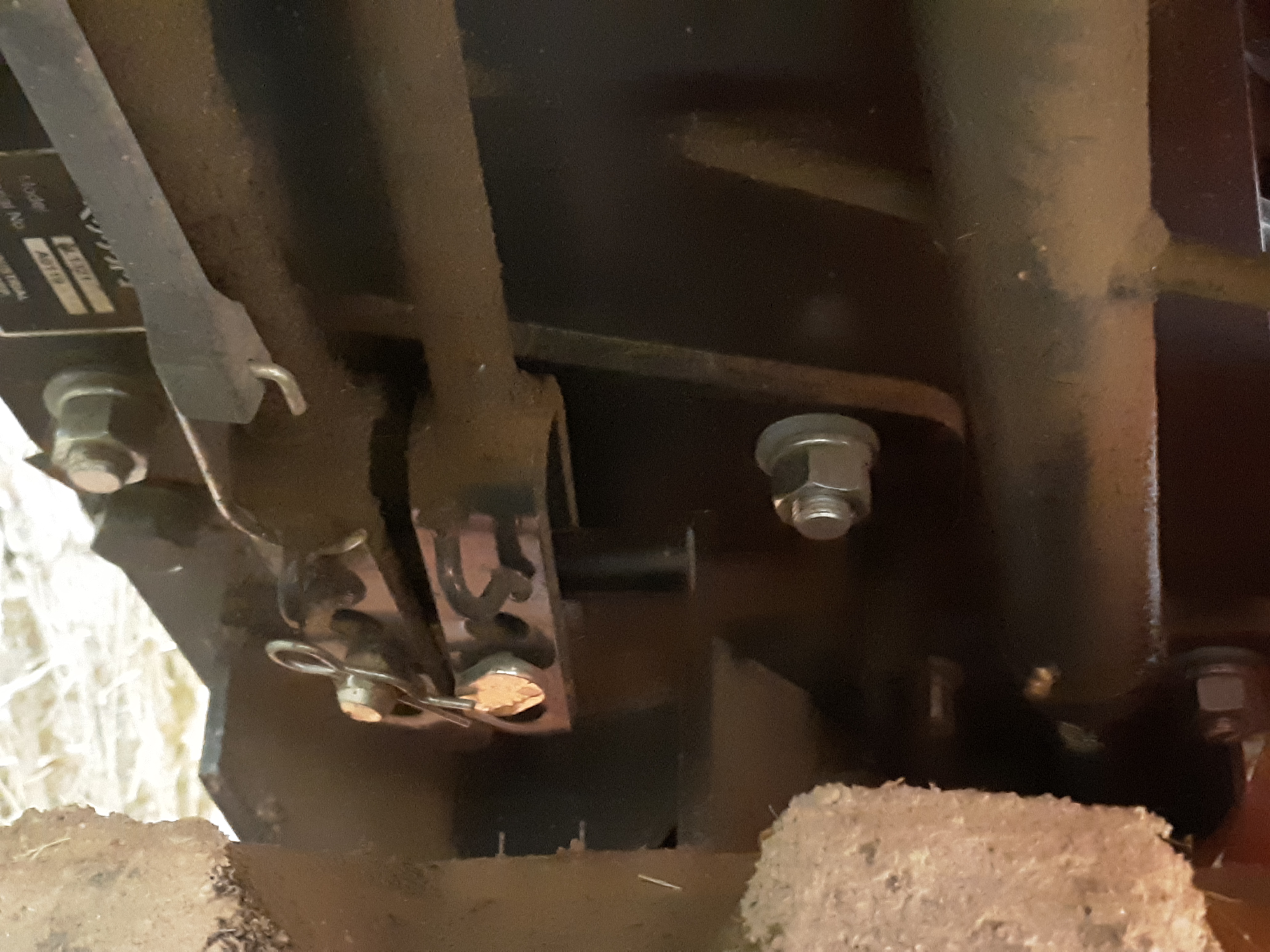

No. There isnt any top linK bracket at all on the machine. The kit came with one. and the pto guard is in the way of a top link also oddly enough.
Plus the storage brackets had little to no scratches in the paint, until i got done figuring out the puzzle of putting the links in storage position.
   / 07'- 530 HRs, Kubota L39 Backhoe Issue #8
I can send you a picture tomorrow of the storage position...
#9
That would be nice.
There are at least two setups. My manual shows the arms stored under the hoe its self, I saw one today at the dealer that had the brackets on the hoe frame just like in the manual for the arm storage.
But mine, no no, not so easy. The hoe frame doesn't have those brackets. There is extra pins under the battery and hooks near the rear tire to store the arms. Which style do you have?
I fought it a while, realized one of the hooks was bent and fixed that finally got both arms on the pins. lol, Then I attached the anti sway linkages to the arms and had a new puzzle on my hands. I still dont think I have them in there right. But They are in storage. Id love to see a picture of how they are supposed to be.
Next week I will take on bolting on the brackets for the top link and draw bar.
   / 07'- 530 HRs, Kubota L39 Backhoe Issue #10
That would be nice.
Under the step in front of the rear wheel.....
