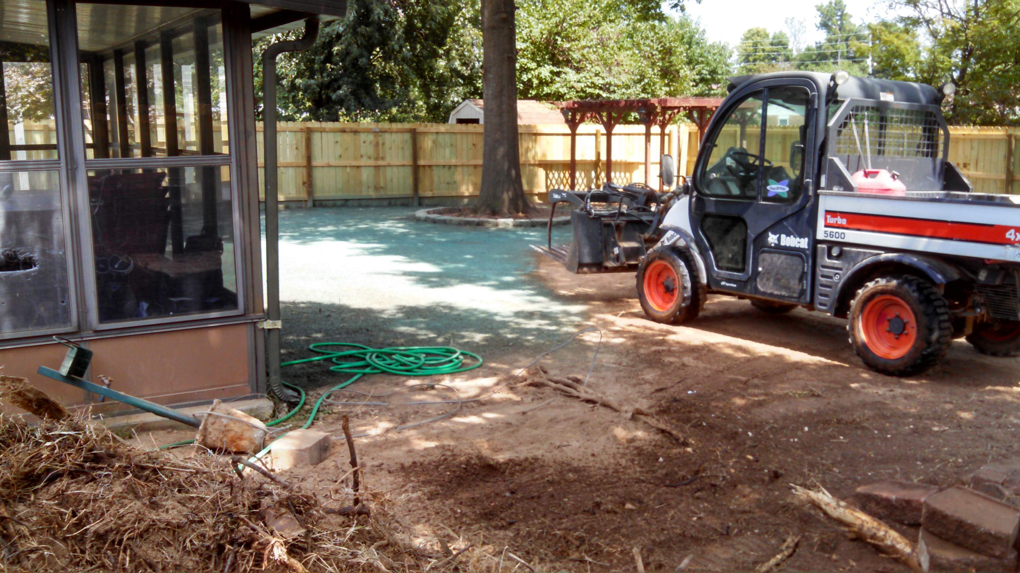

Hello! I've looked all over the net trying to find info about Toolcats and have found more help here than anywhere. I'm trying to find out if their is any other rims that will fit on my 06. My center of stud to center of stud is 3" and needs a 4.5" center opening to clear hub. Apparently the newer Toolcats have different hubs. My stock rims are fine but I'm looking for wider rims for floatation when I'm crossing existing yards without rutting them up. I already try and protect lawns with .75 plywood. But its not ideal for all applications. I've measured trailer rims that talked about here on other post here with no luck of matching. I've called my local bobcat and they said that they don't offer a wider rim for my year.... Any info would be appreciated!

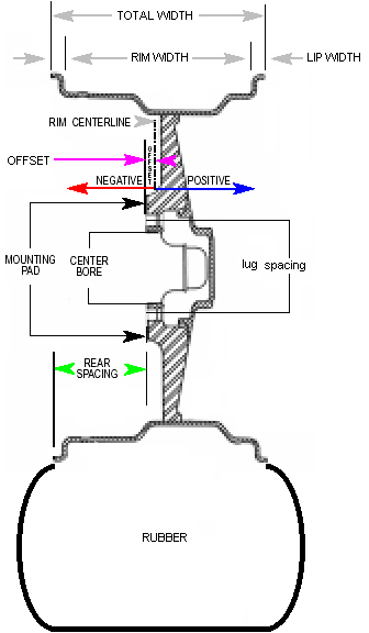

You need the Bolt Circle for your wheels.
Measure the center to center distance of any two studs straight across from each other.
I don't think there are many different bolt circles for 6 hole wheels.
Offset should not be a problem if using trailer wheels.

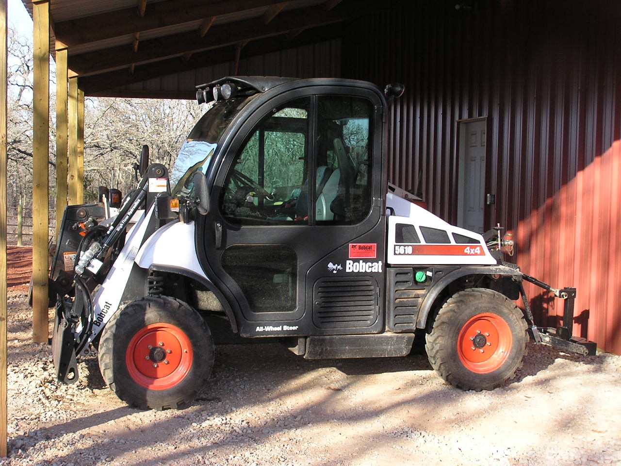

I measured my 5610 Series F (2012).
Bolt Circle is 5 1/2.
Center Hole is 4 1/16.
It has a black plastic screw on hub cover.
29 x 10.5 - 15, 8 PR Trac Tires

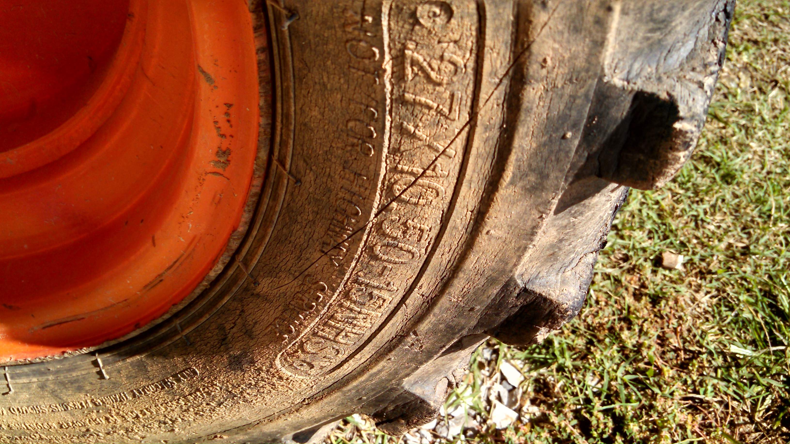

I finally had order a new set of turf tires, I could not wait any longer, mine were pretty much shot. Can't complain, original tractor tread style tires are still on my 06 and have 1950hrs on them. I am still searching for a wider rim. Thanks for the replys.
