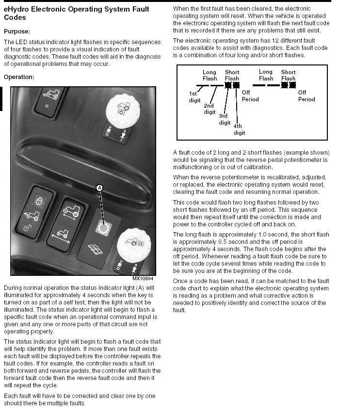

I will appreciate the list of the eHydro error messages which you have.
Thanks, Phil (prwhittle@gmail.com)
   / '03 4210 eHydro error code #5
:welcome: to the forum.
Been a while for this thread, but here are the fault codes. Can dig some more out if this is in line what you want.
