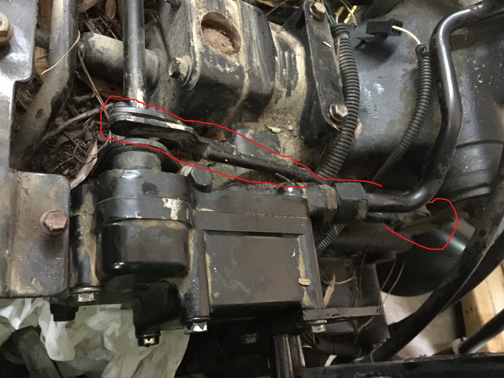

Have a 4400 here with 430 loader, syncreverser trans, rear remotes (5 ports back there: one plugged that says 'To Reservoir, two looped together and two plugged), and what seems to be a factory SVC on the right fender that is cable-operated and springs back to center.
The lever for the 3ph probably has 8" of movement front to back, but only raises the arms in the last inch of movement at the back. Any ideas on what adjustments need to be made there? Or any way the SVC kit could be related? Seems that should raise the arms through the entire range of lever movement.

Will try to help you out. The SVC is likely the 3rd SCV.. and the fender control is how it is operated.. and controls one set of the couplings not looped together in the rear. The other three likely/may be power-beyond for a backhoe or wood splitter..
Linkage adjustment may be in order for the 3 ph to function correctly with the lever (quadrant) control. What you report doesn't sound right, but be sure that the valve is open all the way under the seat.
A good time to pick up a copy of the service technical manual.

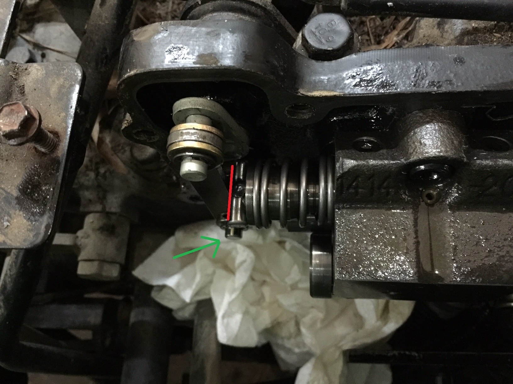

Between your explanation and the parts diagram the 3rd SVC makes more sense now, thanks. Was surprised to see the original valve has the additional ports already. The fender lever is hokey, but hopefully some lubrication will clean it up.
In regards to the 3PH, I took the cover off the rockshaft valve and noticed a few things.
-Oil. Is that normal or a sign the o-ring behind the valve need to be replaced?
-Difference from the 4400 parts diagram. The pic here rockshaft linkage shows linkage 38 which mine does not have. Part 17 connects straight to 41 so there's no adjustment there.
-In this picture below the arm does not make contact with the valve shaft until the 3PH lift lever is about halfway back. Red line shows contact. I don't see any adjustment there. Does that seem right? Seems like it ought to make contact sooner.
-There is a linkage rod that feeds back from the left lift arm to the inside of shaft 33 in the diagram. I can't find it anywhere in the parts catalog but it's circled in red in this pic. Raising the lift arm through it's entire range (and in turn moving that feedback linkage) does not change the position of the arm that contacts the valve at all. Should this not move the bottom end of the arm (green arrow above)? There's a second arm inside the shaft with the green arrow that sits on the same shaft as the feedback arm ( shaft 33 in the diagram above), could it be broken?

Have you checked the parts site to see what parts are included in the 4400. I go to jdparts.com (free registration) and get a pretty good schematics of parts and part numbers. Compare to what you see with the cover off.

In case anyone ends up here looking at a similar issue.....I was able to get this resolved yesterday. I misread the diagram initially and the one linked below (same as above) is correct. For my issue the roll pin that's part #40 was in three pieces and the shaft that's part #33 was frozen in the rockshaft cover. This prevented the arm, part #32, from making contact with the rockshaft valve until very late in the lever's range. I hit everything with some pb blaster, drove out the broken roll pins and replaced. Then I hooked everything back up and cycling the 3PH arms provided the leverage to loosen the shaft (#33).
