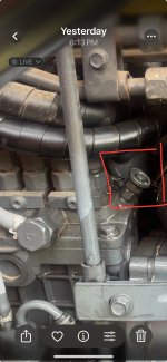

I don’t have a clue how it got the pinhole in it but it wasn’t there last fall when I finished up hay season and fired it up yesterday...

Kubota's all use the hose attached to the bleeder valve to return excess fuel from the injectors to the fuel supply (like most all...

You were correct Harry! The valve is still working correctly. I guess there is back pressure pushing fuel out. $1.10 for some hose and...

I'd say that the bleed valve is probably working as it should. The leak is coming from fuel in the line and coming from somewhere other...

Thanks Harry for the response. I guess I missed it originally and just saw it now but yes it does work letting the injector pump pull...

There is a 1/4” tube coming off the back side of this bleeder valve on the fuel system. Mine has a pinhole in it spraying fuel all over...
