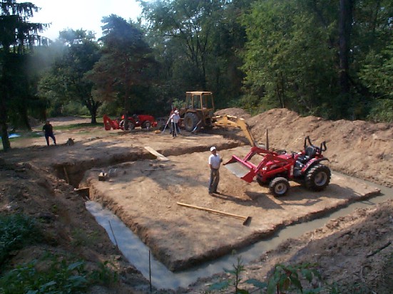

kneedeep
MAHINDRA3510 Mahindra
Pics of 3510 TLB
Model Year: 2003
Added a 509 Backhoe this year. Made a great machine even better. Package now complete and ready for work Review above of tractor
Pros: See above
Cons: Plastic body parts

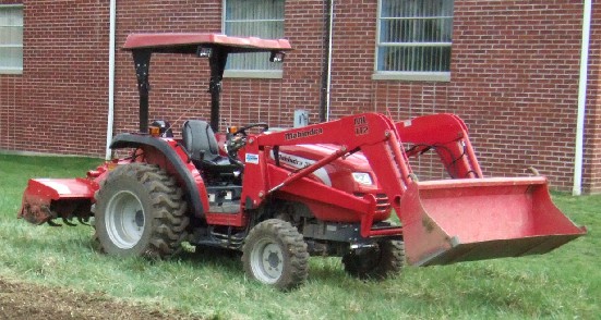

mazog755
Mahindra 3510 HST
Model Year: 2006
This tractor is one of my most valuable pieces of equipment. It is very reliable and has been useful in many scenarios including farm/grass cutting, construction, and general hauling (via the attached loader bucket). I've also used it periodically move a boat around. One observation is that the electrical connection in the back is useless. It is apparently set up for connections that are used outside of the USA. Also, there are no hydraulic hook ups in the back for supporting hydraulic attachments.
Pros: Reliable and sturdy tractor.
Cons: No support for rear hydraulic attachments.
