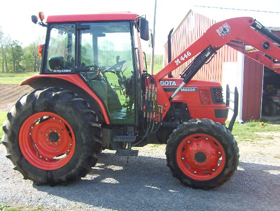

5.00 star(s)
LindaK
M6800 Kubota
Kubota M6800 w/Cab
Model Year: 2000
We have been very pleased with this tractor so far. Strong, compact, comfortable. Great air conditioning.
Pros: Unrestricted view from cab.
Cons: None yet...
