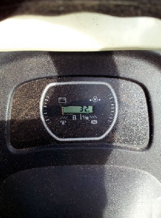

I purchased this 2008 built machine (with only 30 hours on the clock) in June 2014 for only $2,500 AUD. When first released, I was told they were approx $6,500-$7,500. It was absolutely spotless, except for the broken bonnet where the screws have broken the retainer mounts. I've been told that this was a common manufacturer's problem with some models. To me this is only cosmetic (4 cracks on the plastic), but it has been strengthened and bolted right through now. It is equipped with a 20 hp V-Twin Kohler Command horizontal shaft engine which seems to be more than ample. The fuel tank I would say is a bit small (approx 10 litres). I would suggest at least 1/2 that again. The deck is very strong and I like the simplicity of the direct shaft drive to the transmission, leaving only 2 belts - the PTO and the deck belt. They are both very easy to change and the deck is very simple to remove and reattach and is grease-able. Diff lock would be an advantage. Overall, I would recommend this garden tractor for the price I paid ($2500 AUD).
