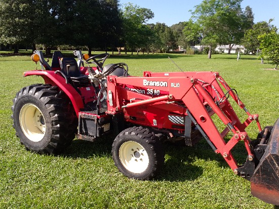

4.00 star(s)
jdost
3510 Branson
Branson 3510
Model Year: 2005
I purchased this tractor from a case dealer in Bunkie Louisiana in October of this year. It had a problem with the three-point hydraulic valve when I got it. The previous owner had put the seal in backwards, but had given me a new seal. Once that was replaced the problem went away. This is a well built tractor. It's quite heavy, in fact it out weighs the Kubota I had by over a thousand pounds.The loader is the nice feature of the tractor. It goes on and off easily. The controls are a little sluggish at low RPMs, but at medium RPMs it works fine. I have been quite satisfied with the tractor so far. The only thing I wish it had is a draft control, but I think that can be installed later.
Pros: Well built and weight
Cons: Hydraulics at low RPM

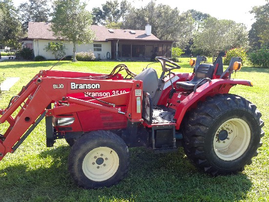

5.00 star(s)
floydtimothy
3510 Branson
Branson 3510
Model Year: 2003
This has been and is still a great tractor. It is just the right size to work on my small farm.I have a front loader and the backhoe so most jobs I can do myself.
Pros: Well built-great gear range-easy to service.
Cons: Weak seat frame. Plastic tank for the power steering cracked.

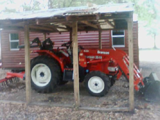

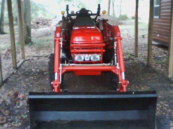

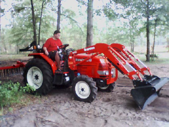

wayne6215
3510 Branson
Branson 3510 - A real workhorse
Model Year: 2004
Living on 100 acres there is always a need for a tractor and the Branson 3510 has proven to be one of the best investments I ever made. Equipped with front end loader, landscape rake and brush cutter there has not been any task the 3510 has not performed. The primary use is clearing paths within the planted pine forest and handles this task with ease. The front end loader was bonus during one of the hurricanes a few years back. Several large oak trees (40') were partially uprooted and the Branson loader was able to complete the process of unrooting and "pushing" these trunks out of the backyard to a disposal area. In this instance, Branson 3510 saved me a lot of money on having the uprooted trees removed. It is very dependable and always starts right away.
Pros: Very rugged and dependable; a real work horse.
Cons: Not the easiest to work on, but patience gets the job done.

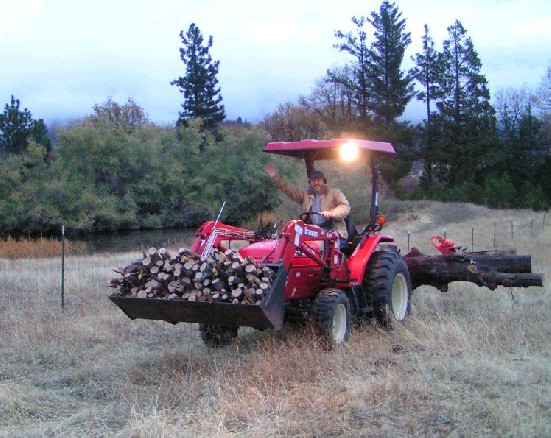

ColestinValley
3510 Branson
Branson 3510
Model Year: 2004
It's been over five years since the Branson 3510 was delivered to my place (by Dave's Tractors, Red Bluff CA). Since that day, the Branson has been a constant companion and has never failed to deliver. I maintain a mile of private road, plow snow, and bring in 6 cords of firewood yearly, our only heat source, but there is almost no project that does not end up involving the tractor somehow. Our temperatures ranges from 110 degrees down to two degrees Fahrenheit, and the Branson has never failed to start. This machine has a shuttle-shift, so it loses less power to the transmission than a hydrostatic would. For dragging road maintenance implements I recommend it. The only time that power seems like a limitation is when using the backhoe. though it does a fine job digging trenches, it isn't quite up to really big holes -- like septic systems or cisterns. It's also a hassle if you have to move the tractor often while digging, since you have to dismount from the hoe, get in the driver's seat, move the tractor, then get back on the hoe. If backhoe is your main use for a tractor I recommend getting something where you stay in the driver's seat and just swivel. But for everything else I love this machine.
Pros: Shuttle shift makes efficient use of all 35 horsepower and is great for pulling.
Cons: Driver's area seems small. Someone over six feet might feel cramped.
