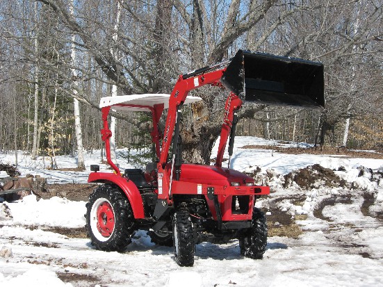

I've had only two problems with tractor one was starter after a few months of use Dealer came right out and replaced it the other problem was with lever 2 wheel drive 4 wheel drive weld broke bad weld they came right out and fixed problem no charge. Tractor starts right up in winter I keep it in pole barn unheated when I bought tractor I had a Koyker 160 loader installed it works great only problem rubber boot on controller split in half. I would buy again I had a dealer who was well informed and had tractor all ready to go Delivery was free.
Pros: lots of power for my needs, great tractor for the money
Cons: had to disconnect horn button got stuck never used any way
