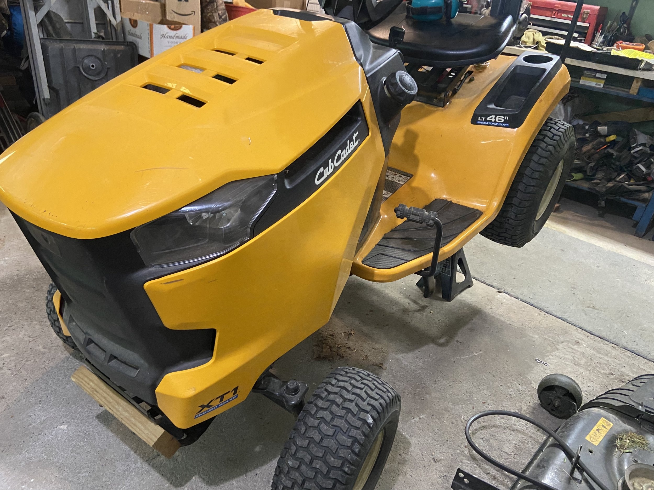

Good afternoon. My xt1 46” just stopped moving forward and reverse. Motor is running strong and belts are all fine as is all the linkage. Any other ideas in what to check for? Thanks much!

Make sure that the rods that allow you to move the tractor by pushing it are in the correct position.

If you have good input, maybe one of the wheel hubs are no longer locked to the shaft. I don't know if your axle has a double d shaft or is keyed.
