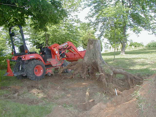

a little time off for the memorial day holiday, put it to good use. i hesitated for quite a while before i tackeled this one. the little bx is amazing

How about a play-by-play, for us beginners?
   / too big
i started out by scooping down about a foot on one side, then i went to the other side and cut it down about a foot, the stump was tall enough that i could push on the top wit the bucket and watch the ground around the stump, that way i could find the other roots. i moved some dirt off these and was able to finally push it over, then i got the bucket under it and shoved it up out of the hole. i should have removed the mmm first as i almost got stuck in the hole. it took about a half hour to get it out. could barely lift it high enough to get it into the trailer and haul it off.
i got out several smaller stumps before i started on the big one. i'v got three more about that size but they're cut closer to the ground, i'll save them for another time.

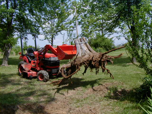

Milkman's quote for this picture is:
I'm glad I got pictures, it's a locust stump and it's as hard as a bone.

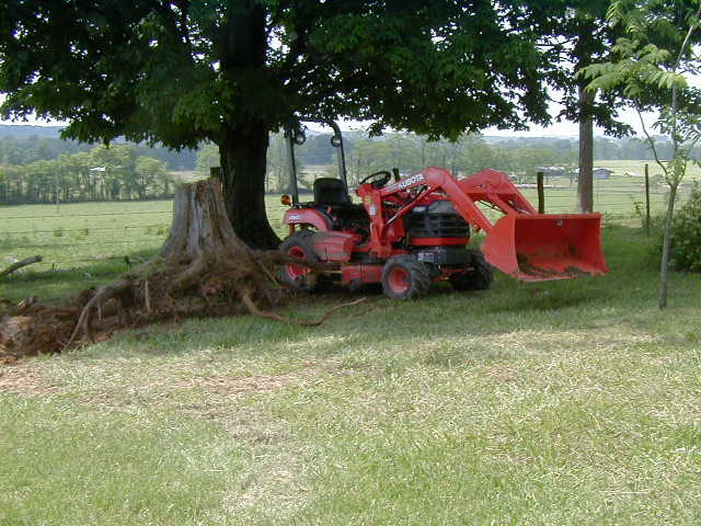

Here is another one I moved over here for you.
Don't know what it weighed, but I could lift it with the loader
