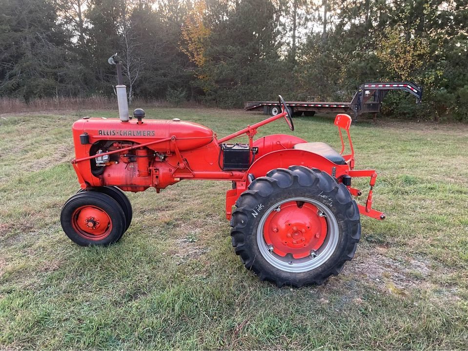

I always thought most people that had vintage tractors like this either had it passed down or found one like grandpa used to have. Thinking it was just for the nostalgia.
Here I am, a guy who didn't grow up on a farm and nobody in my family unless you go way back has either. I just got my first tractor (Kubota M7040) that suits my needs, and yet I'm drawn to this little Allis Chalmers.
The current owner uses it with a 6' finish mower but I have a zero turn. I could however, use it with a 4"-5' flail mower to keep the weeds at bay on the trails of my property. A small flail would be perfect with one drive in and one drive out. So for a total of around $3,500-$3,800 I'd be set with tractor and mower to do about a mile of 7-8ft wide trails maybe 7-10 times a year. And get to enjoy a neat little vintage tractor.
The little Allis Chalmers looks to be in nice condition other than maybe needing a replacement battery box which are available and replacing the LED light assemblies with something more period appropriate. I believe he did do the 12v conversion which is nice. I'm pretty sure I can get it for less than 2k.
Any thoughts?

It's a nice looking machine and all. Something to have around for nostalgia or just enjoyment. However, I think I'd rather use a zero turn mowing established trails than a tricycle geared tractor with a flail mower. Especially if you're going to be doing them that many times per year. The grasses shouldn't get that high between mowings, and, the more often you do them, the faster you can mow.
So just questioning why you wouldn't use the zero turn on the trails since you already have it?
I try and maintain several miles of trails on our property, and find that the more often I mow them, the less actual time it takes to mow. If I lived out there, I'd mow them every week, just like the lawn. It would only take me 40ish minutes to mow 2 miles of trails double width.

I could use the Allis with a 4' - 5' flail mower to keep the weeds at bay on the trails of my property.
Harry Ferguson's patents on the (Ferguson) Three Point Hitch, licensed to Ford but not Allis Chalmers, did not expire until the mid-1950's.
It is probable this 1949 AC/C has an AC proprietary rear hitch which will function conveniently only with scarce proprietary AC implements. Question the owner.
Somewhat ersatz aftermarket Three Point Hitch conversions are still available.
Not viable over hilly land.
Caveat Emptor.

I'd love to have one but that paint job would make me look very closely for other corners cut during the restoration job. Looks like it was split and painted at different times with different colors maybe?
