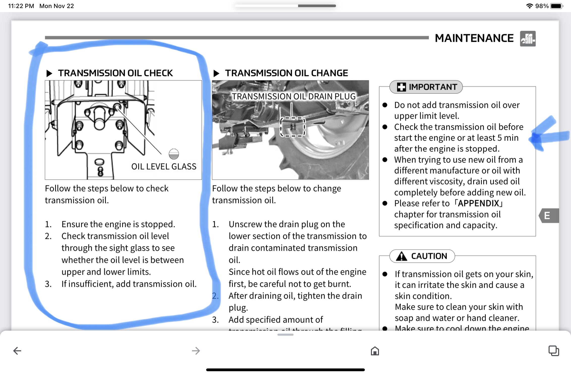

Found this from RK25 manual. If your sure it’s high you can change hydraulic filter and that should drop it some. (See pic for checking when cold)
You know I did see that language about checking the fluid 5 minutes after shutting engine down but I thought that was
to allow all the fluid to drain down. I didn't think the fluid would be cold after just 5 minutes. I wouldn't think the store
would let it get delivered overfilled if it would cause a problem, but mistakes do happen. I have written to the ask the
RK tractor guy site and asked about it. If I get an answer I'll post it. Thanks for your reply

Ok, thought I'd post this follow-up. I talked to RK service guy at Owensboro, ky RK about Hydraulic fluid level being over the sight glass. He said tractor comes that
way from distribution center with fluid level above the sight glass to provide oil for implements that may be used on the tractor, and that fluid level on
my tractor of no concern.
