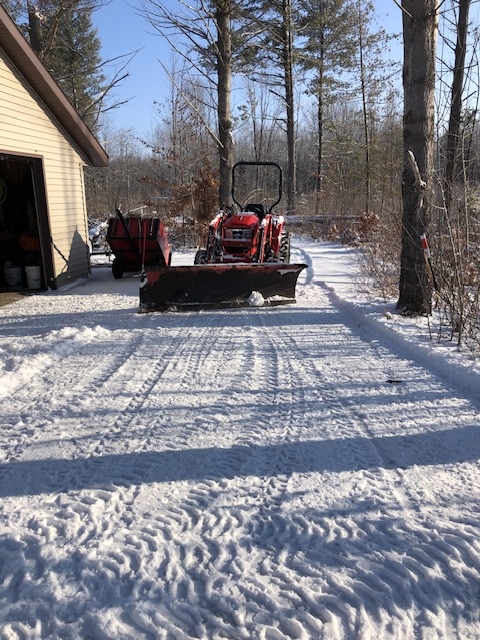

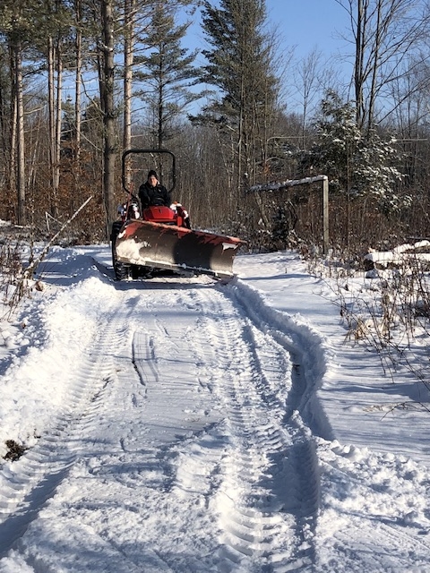

Homemade plow . Paid $500 . Works good so far . My driveway is 1800 feet long and the going rate for someone to do it was about $125 per time . Last year it basically paid for its self . I need to throw some paint on it and I replaced the chain that goes from the plow to the quick attach plate.
