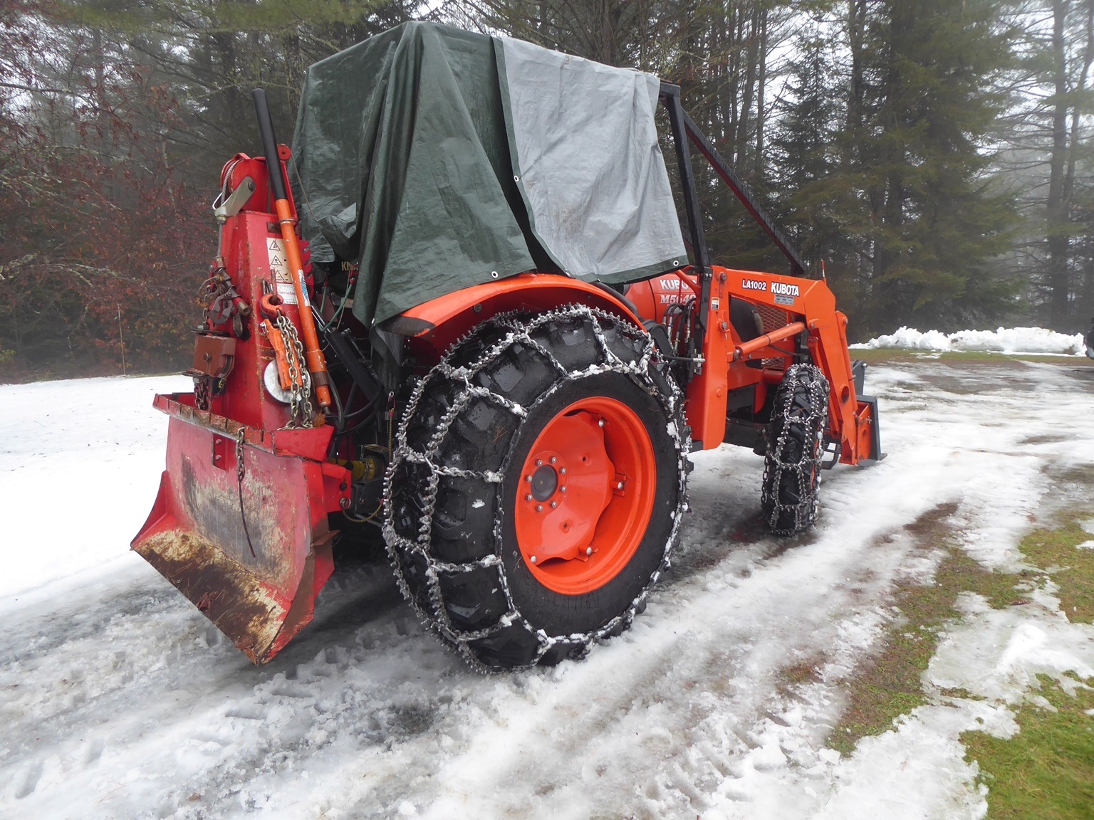

These are OFA Eko 9 chains. I like "H" pattern chains for my R1 tires because they can't hide between the tire lugs and become less effective. I mount them using the "drive on" method - it is so easy. It's been shown before but worth repeating I think.

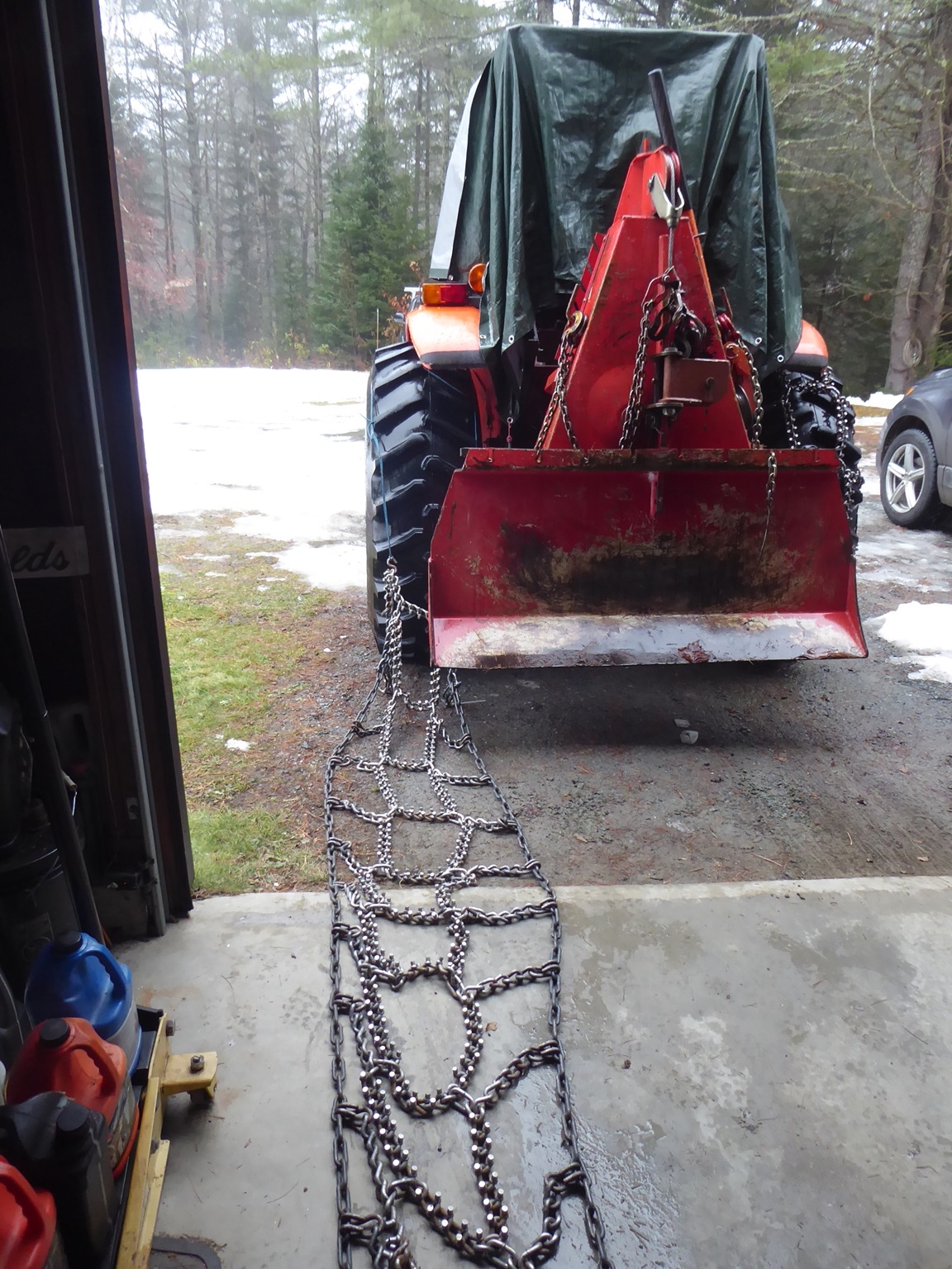

I have a length of rope with a hook on each end. I hook the chains near the center and loop the rope over a set of tire lugs.
Then drive forward, stopping once in a while to make sure the chains are centered.
When you get all the way around the chains are tight and with "H" chains there is plenty of slack over lap to easily hook the centers. More than 6" in this case.
Then when you hook the side chains and close the long cam levers everything tightens up - easy peasy.
gg
