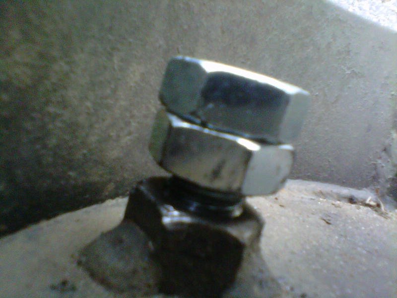

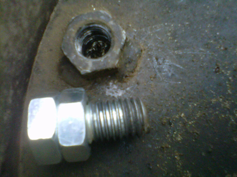

Here's a trick that works well for me to remove a broken brush hog bolt on my PT425 48" brush hog.
I replaced the stock bolts with 2.5" bolts the first time they broke. That leaves about a 1.5" stub inside the hub. I use jam nuts and a wrench to back the broken bolt out from inside the hub.
It takes about 20 minutes if you use air tools and your compressor doesn't toss a belt, break its tensioning device and your kid doesn't spring a last minute 5 mile cross country training run on you that you have to follow on yuur bike. Then it takes 4 hours.

Lol, sounds like one of my typical projects. Nice mod.
