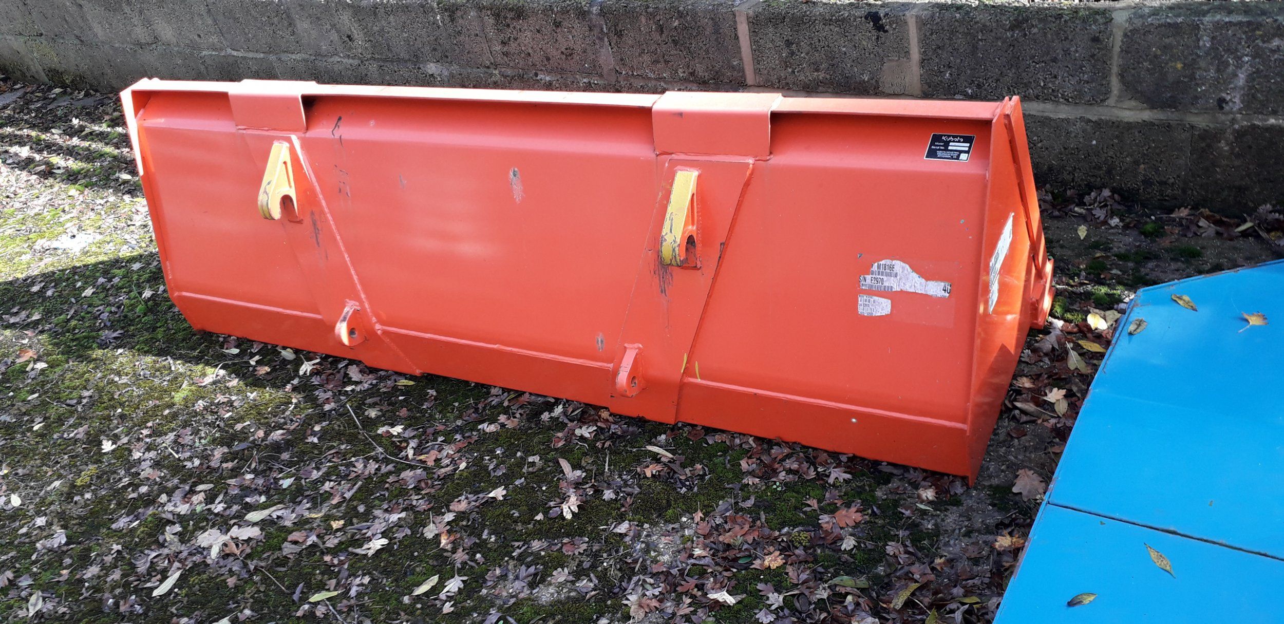

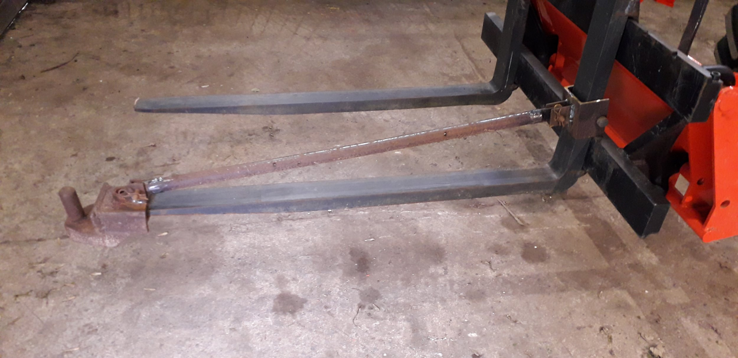

I don't understand why you folks in the USA and Ca. are so wedded to bucket forks, surely it must be difficult to see the fork ends. Is it because most people are living in the dark ages and have to knock out pins to take their buckets off?
I think that some type of quick attach system is essential in this day and age. I know that some of you use the skid steer quick attachment system for changing attachments. Here in the UK, the euro bracket system has become pretty universal for the f.e.l. manufacturers, whilst the tele-handler makers tend to all use their own systems.
Here is my Kubota bucket with euro brackets welded on. Thee yellow paint is to make the hooks even easier to see. I also have included a photo of my pallet fork attachment fitted to my previous tractor, an M7040, using euro brackets. The hook on the pallet fork is for moving trailers about.
