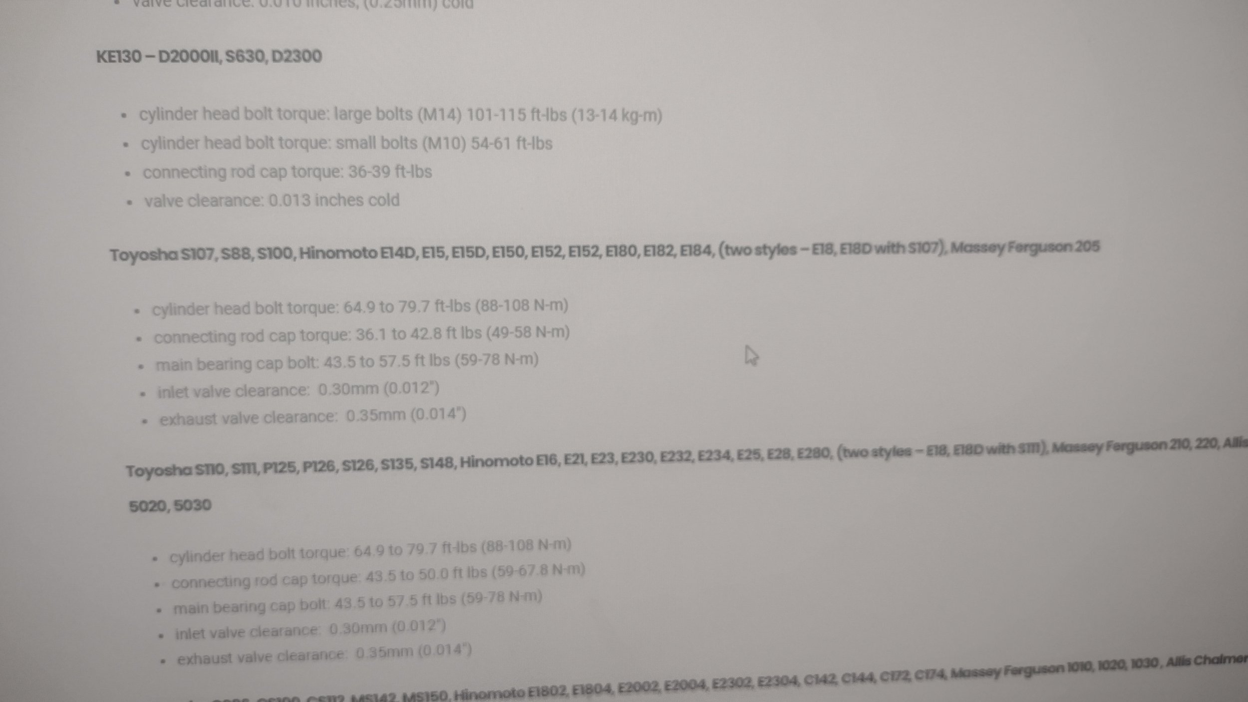

Looking for a scan of the torque spec and tightening sequence for the Hinomoto E15 scut. Also need a complete muffler/stack assembly, and the whole air filter housing with rubber intake hose. A complete service manual, even in pdf form would be super nice to have. Thanks

You can get a service manual reprint for a Massey Ferguson MF205 from Jensales which is the same tractor.
Searching for MF205 muffler yields a number of results -you can even buy one on (sc)Amazon. Be careful as the 205 is a common Massey Ferguson industrial tractor -you need the MF205 or MF205-4 which was the late 70s early 80s grey market Hinomoto made CUT.
Try Southern Global for parts.
When I've been unable to source intake hoses, I've had good luck using the generic silicone hoses/bends in appropriate sizes from ebay.
Southern Global also lists torque specs for your 2cyl Toyosha S88 on their website for the E15:

Also be aware that the MF205 used the Toyosha S107 which was a slightly larger version of the S88
