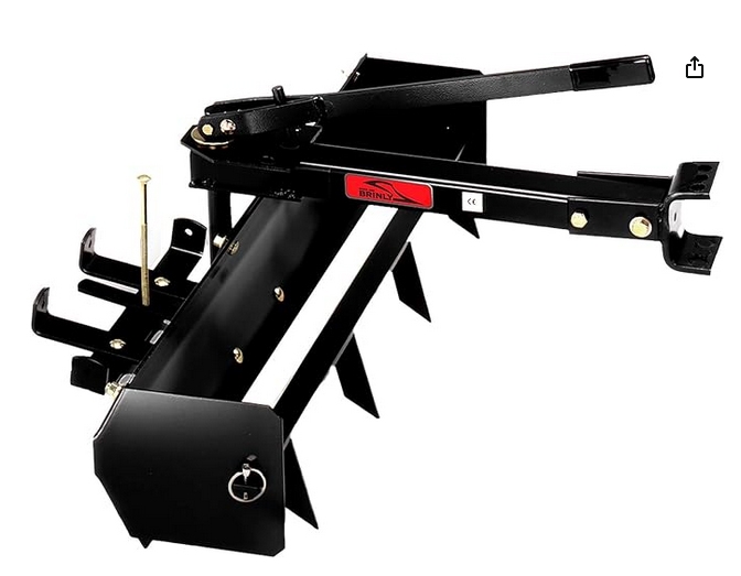

I have one of these box scrapers that I bought 7 years ago for my little JD garden tractor. Tractor gone but the box scraper is still kicking around.

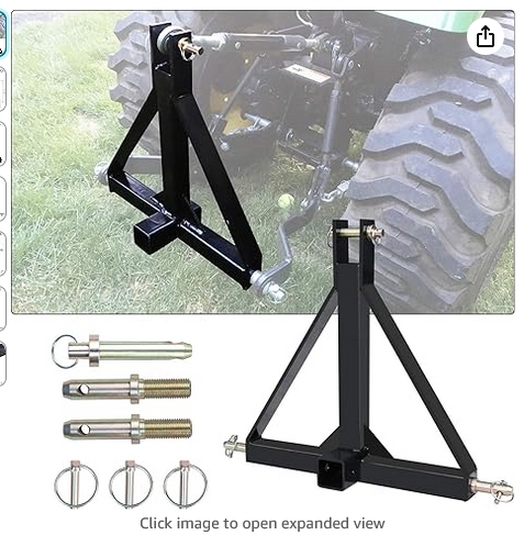

I also have one of these for my SCUT
Is it worth the money ($100+) to buy a sleeve hitch adapter to use the box scraper with my tractor?
Anyone see me running into any issues trying to use this thing?

Nope; sell it, buy a proper one. A subcompact tractor will eat that Brinly. It's a good product, but wrong class of equipment; not to mention it won't cover the track of the machine.
   / Old box blade for garden tractor on my new SCUT? #3
Got to agree. Anything with real pulling power will fold that thing up on the first thing that gives any real resistance.
If youre willing to try anyway it does look like it might be a 2” square tube already under that sleeve hitch piece so theres a chance you could just remove the sleeve hitch yoke and slide that tube right into your ‘trailer mover’, either making a new crosspin hole (5/8”), enlarging one of the cross holes already there, or just using an undersize pin/bolt to fit an existing hole. I think its an experiment you’ll abandon quickly. You now have the power to use ‘the real thing’ so keep your eyes peeled for the right deal! I pull a 60” with my tiny B6100 and wouldnt personally go down to a 48” so my .02 is look for a 60”.

Not really a good idea was really what I was already thinking and wanted to confirm that others thought the same. If I grabbed on something substantial that did not give the tractor would just bend it or pull it apart. I was just thinking maybe I could use something that's just getting in my way. I'd give the thing away just to get rid of it. Tired of tripping over it. :(

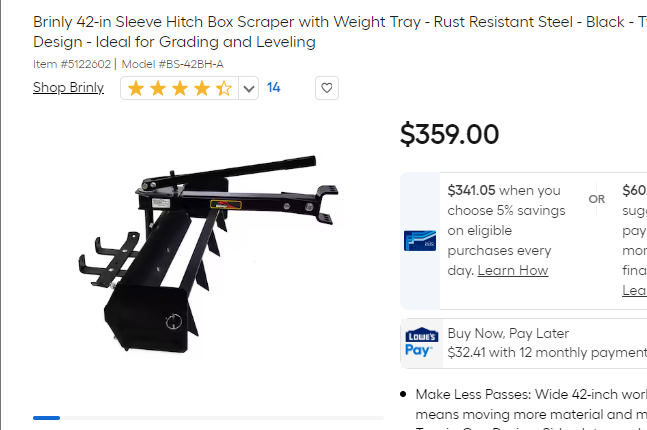

Put this pic of a new one in the photos along with the actual one. You will get at least $100 - 150 out of it. I use that method when selling attachments. I agree with getting a proper box blade for you little GC. You can get them for as cheap as $500 used if you watch for a while. I would never buy a new box blade.
