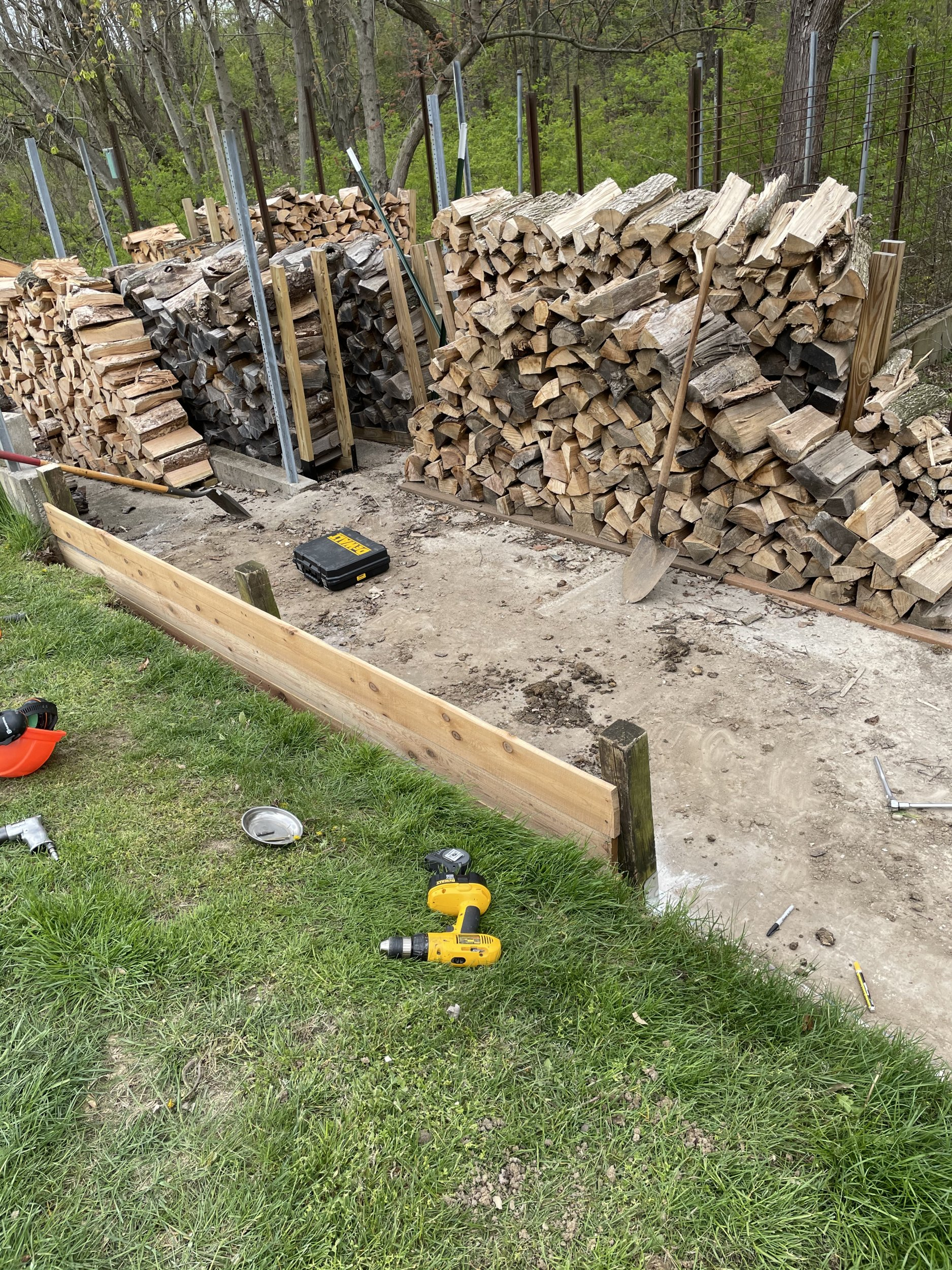

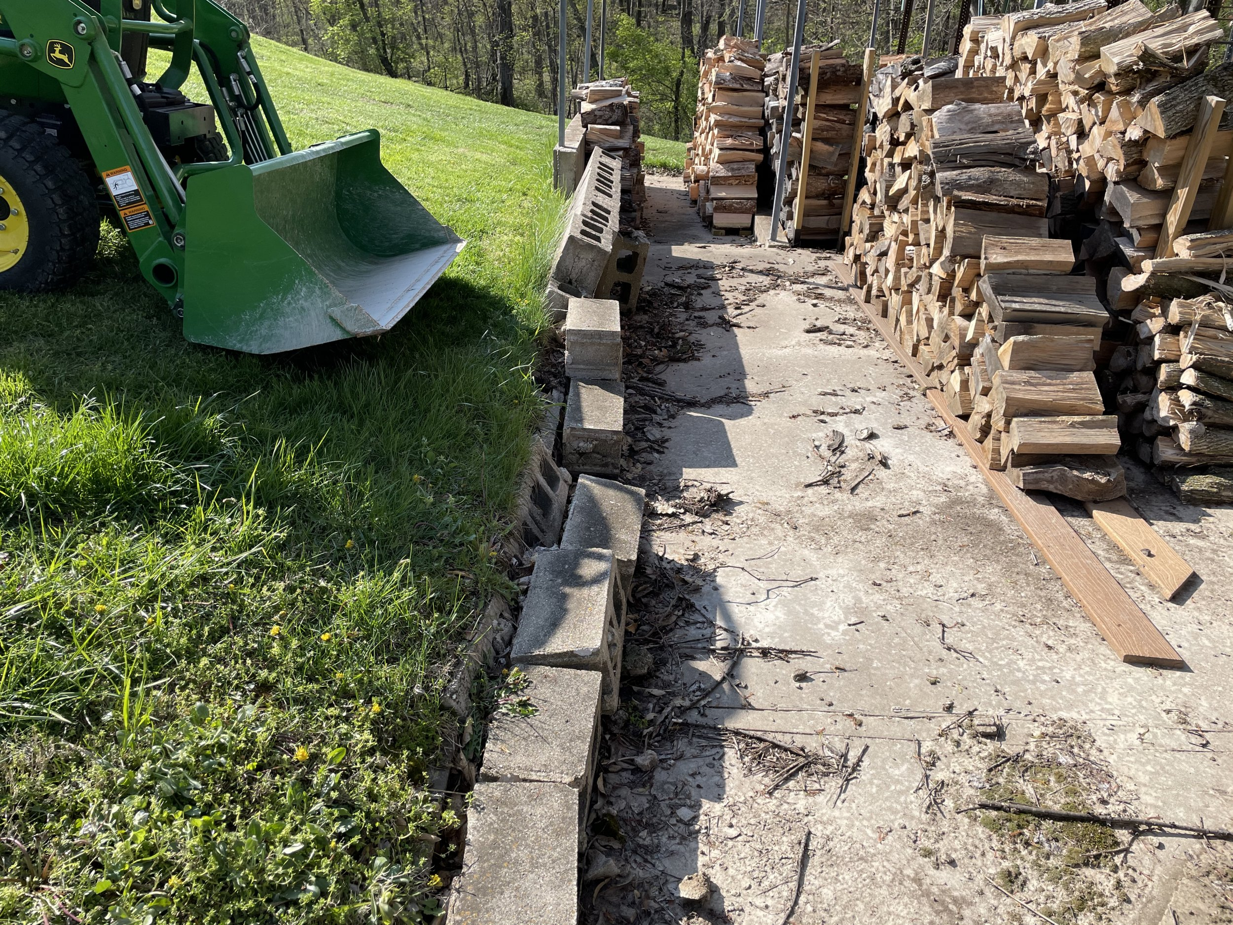

Under the “Tractors and Wood” thread I posted how I helped a buddy load some power poles that were cedar and he had them milled into lumber. He gave me a few boards and I used them to build a retaining wall. This area had a shed on it and was a pretty fancy kennel that had deteriorated over the years and I tore done the small building years ago. The block wall fell over a couple of years ago. I use the area as firewood storage now.
what it looked like when I started.

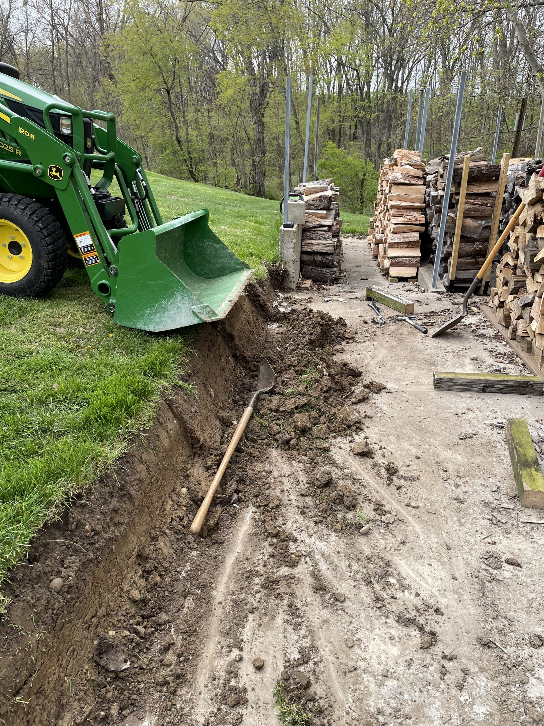

what it looked like after I got the old blocks dug out and some dirt layer back

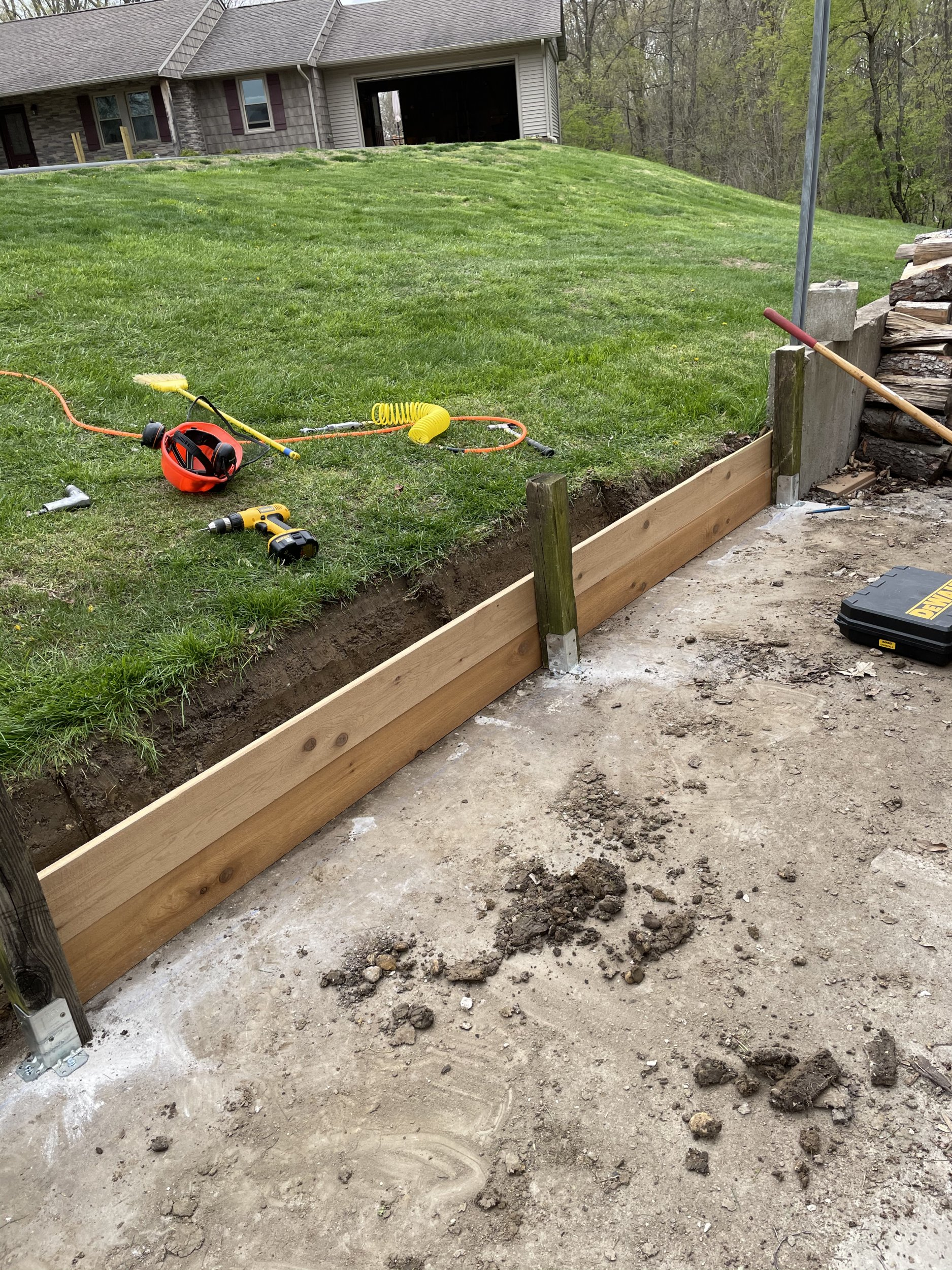

The wall mostly built, I was able to anchor some brackets into the old concrete floor to hold the 4x4 posts.
The wall finished except I need some boards to finish the area to the right, I need three more 8 footers.

I was trying to figure out what happened to the block wall. One row was leaning into the hill..

Actually the row you think is leaning into the hill is the bottom row and is leaning away, but I see what you mean, the pic does make it look like it’s leaning into the hill.
The block wall had mortar in the pockets but no rebar, it just tipped over. If you look past my new wall they have a poured retaining wall that is holding up well. Why they did this section in block I don’t know.

I figure the wall may last 20 years or it may last 5. I could grade a lot of dirt out of the area and have no wall at all but then water woukd run across the pad. There did appear to be a washed river gravel along the base of the wall but it had silted in and mixed with dirt. The posts are anchored with brackets with concrete anchors and are pretty solid. At the highest point the dirt is about 18 inches high.
