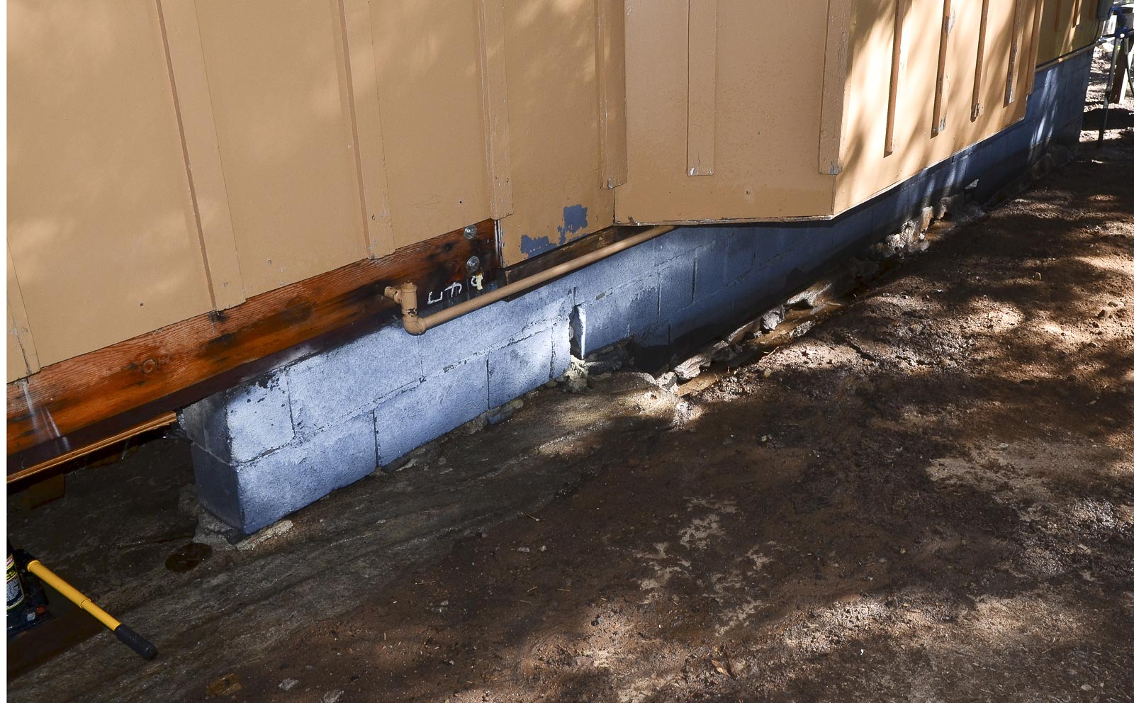

I have a older cabin in the Lake Tahoe area. We get pretty intense snow loads, this winter we saw more than 630" of snowfall. The downside is that it really takes a toll on structures especially those that are questionable to begin with.
The footing is super solid, the concrete block stem wall on a section about 25' log is terrible. I need to replace it. Its from 2 to 3 blocks high, 8X16" blocks. Its filled, I don't know it is has any rebar. My plan is to get under the cabin and pick it up with jacks, knock the block out and form it up. The usual rebar schedule both horizontal and vertical would be followed. Anyone ever done this or have other options I might consider? I have lifted homes before, but never completely removed the stem wall.

A couple of questions. First, when you say it is falling apart, do you mean that the block is fracturing and breaking away from the grout?
As you are probably aware, the strength of CMU's per ASTM C 90 is 1900 net psi. (1500 is typically used in in engineering a composite structure such as a wall). The real weight bearing component of the wall is the grout.
Second question. Has the structure settled any? If not, then you don't have to replace the block.
I would chip away any loose spalled sections and just plaster it. The block is really just a form for the grout.

Here is a picture of the block stem wall. The footing is quite solid. The picture does a poor job of illustrating how the block is tilting outward. Basically the first row of block is sitting on a narrow strip of mortar laid up pretty high to accommodate a large gap to get the block on level.
