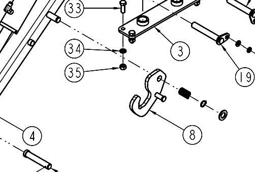

First, what is this thing on the stabilizer leg for (item #8)? I cannot find a use for it.

Do not lift the wheels off the ground. Use the stabilizers to support some of the weight but do NOT lift the wheels off the ground. The second decal is not correct. It should say to prevent damage to tractor DO NOT lift wheels off the ground. Page 14, first paragraph in the manual says do not lift wheels off the ground. There were some changes made because of a few broken transmission housings apparently caused by a backhoe on the first MT225S tractors on the market. The backhoe was redesigned and owners were instructed not to lift the wheels off the ground to prevent this problem. The seat does not lift by itself. You have to pull the release lever and lift the seat manually, and yes it will take some effort because it's heavy. I think the strut is just a damper for the seat suspension. The picture is not very good so it's hard to tell what it is, but it looks like the latch to lock the stabilizer in the raised position. Make sure they are unlocked before trying to lower the stabilizers. Sounds like your dealer did not do a good job of showing you the features and giving some instruction on how to operate when you bought it. My dealer spends a half hour with each customer when the machine is delivered to show them how to operate everything and how to maintain the machine and answer questions.
