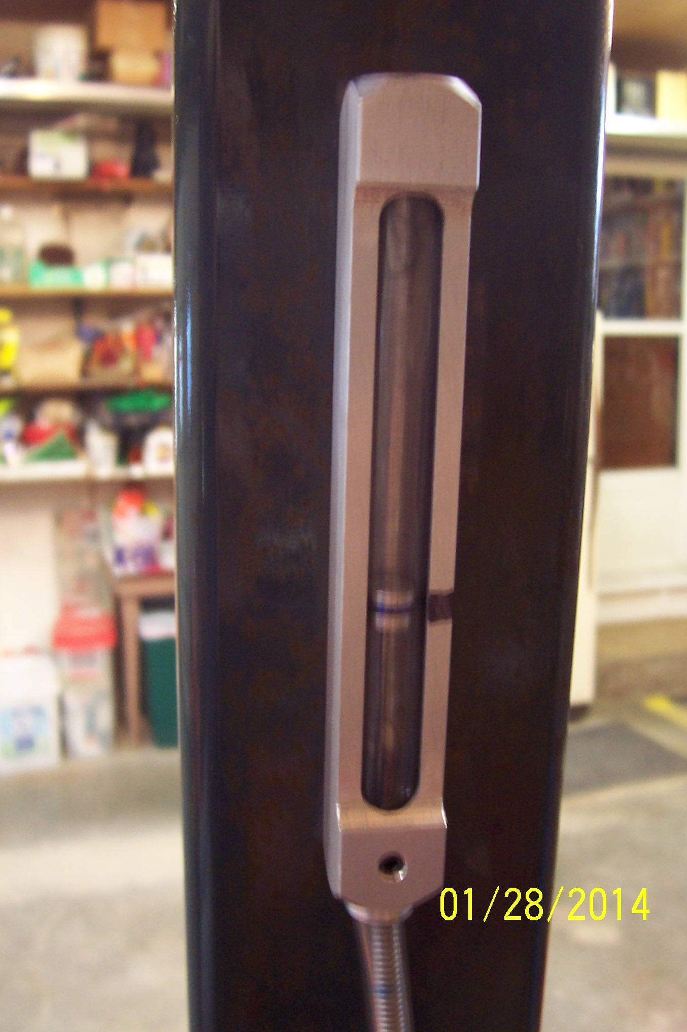

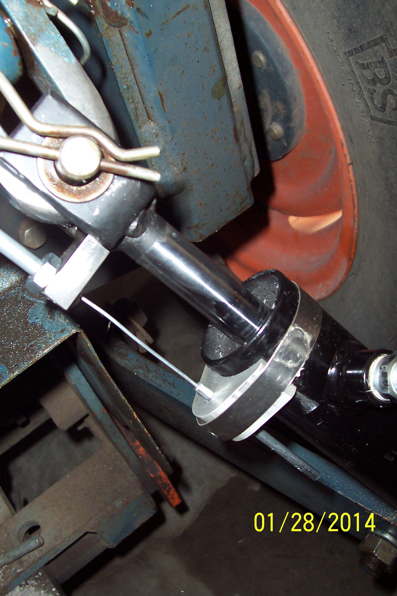

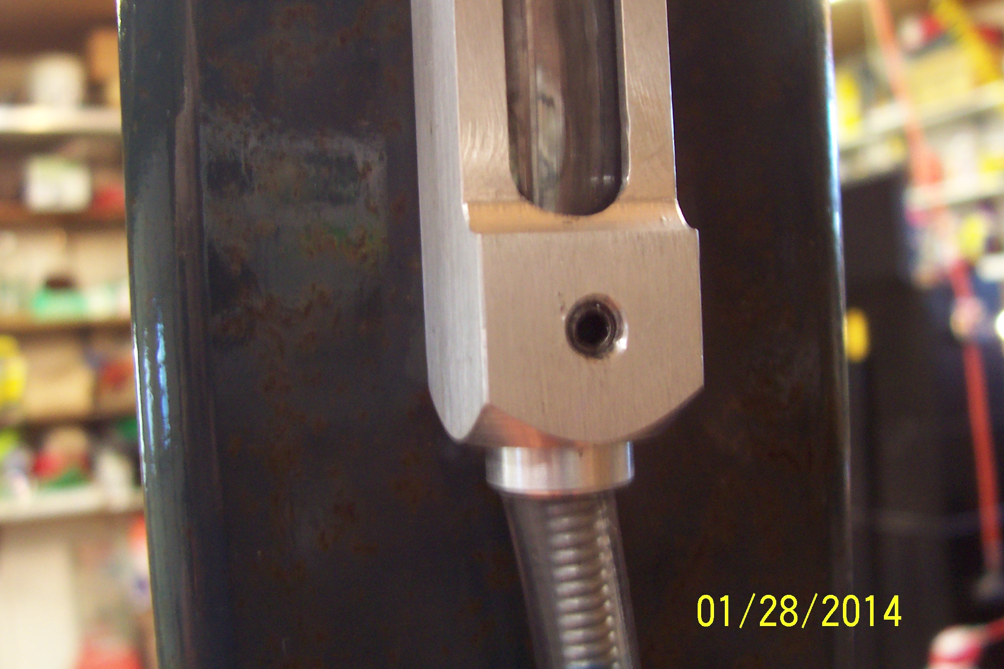

I used a throttle/choke control cable to come up with this level indicator which is mounted at eye level on the ROPS. The indicator housing was drilled and milled out of a 3/4" square 6061 aluminum and has a 1/2" OD plastic hose inside to house the slider. A long piece of 1/4" ID clear plastic hose is slid over the cable to keep moisture out with the end extending up into the indicator housing. Probably should make a scale to attach next to the indicator window with an adjustable "level" indicator. The leveling cylinder is smaller than most at 1 1/2" bore x 4" stroke but seems plenty adequate given the 3PT lift capacity.

I should mention that the main reason for adding this indicator is that I can't see the leveling cylinder from the tractor seat.

My main reason for building this was to enable quick re-leveling after running the blade tilted. Would normally re-level by bringing the blade or other attachment down near a flat surface then leveling with the tilt cylinder. The level indicator allows this to be done on the go which is much faster. The indicator levels to the tractor which I prefer over leveling to gravity. Incidentally, the last picture above appears to show interference between the cylinder shaft and the ROPS. That is an optical illusion.

I'm surprised that no one asked how the indicator is attached to the ROPS.
