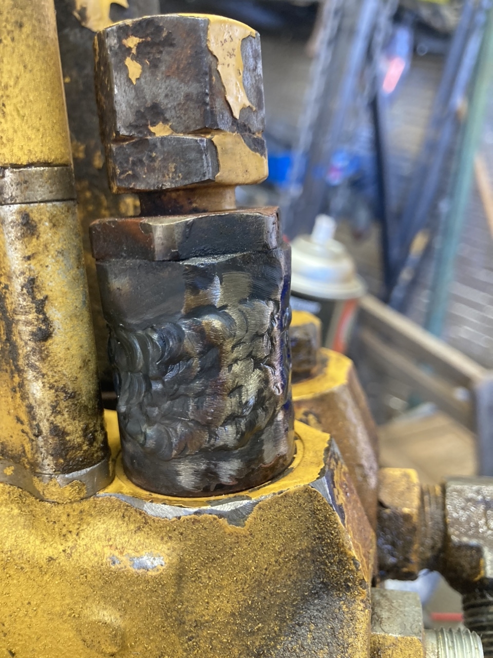

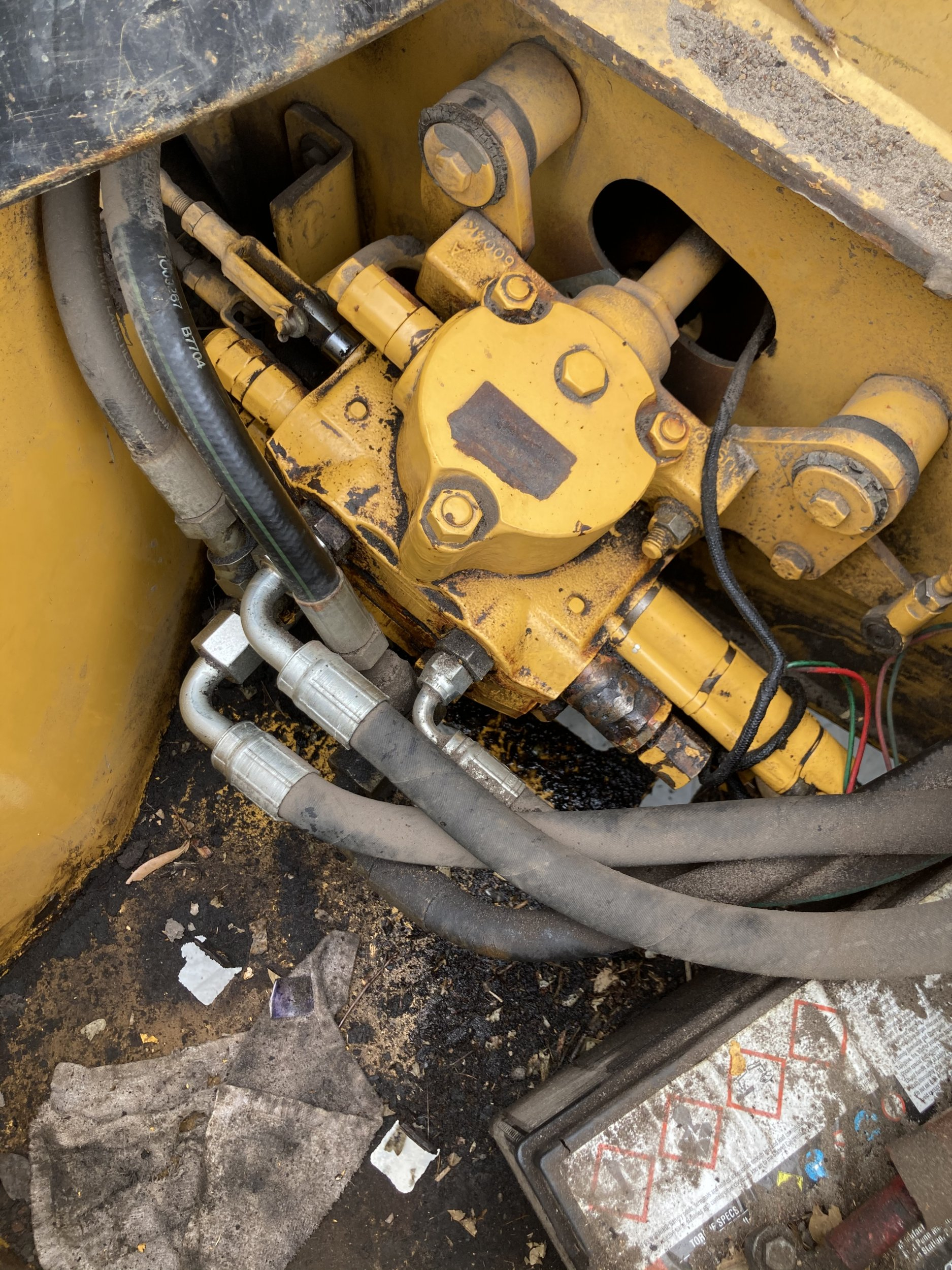

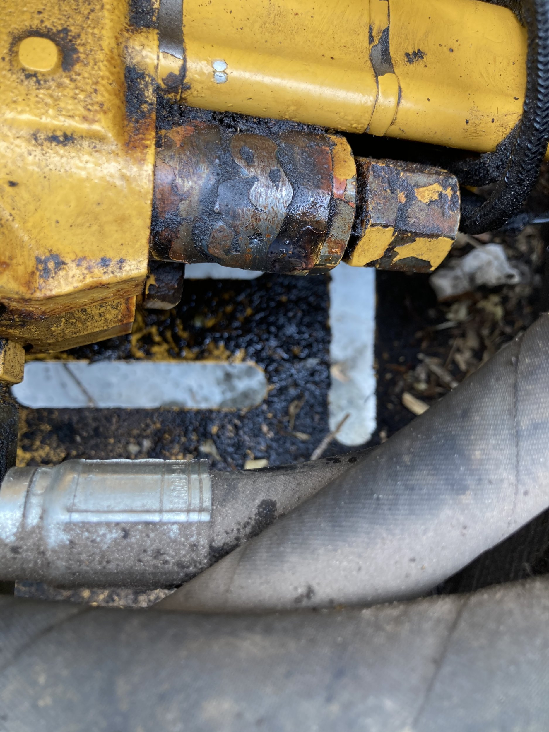

1998 John Deere 310e. Someone welded this valve in the past and it’s leaking on the bottom. I wonder if it can be welded again? It costs like $3k I’m sure.

Its actualy prety difficult to get a weld to seal hydraulic pressure. But it's very cheap to remove, weld and re check many times.
I had a excavator cylinder that needed a hard line welded on. It took me about 8 trys to get my TIG welding to seal it properly. MIG welding was a total loss.

I left it sit for a month and it doesn’t leak any where near as bad as it did before, probably due to heat and heavy use.
the mechanics I talk to say that the thing that was welded is a relief valve and o might not be such a brilliant idea to weld it again.
there are no new ones available and used start at $800-2000

Local machine shop I think tig welded. I came back to this post because I hoped I had pictures of the linkage on the left-thank God…I didn’t note one thing I took off, but it’s in the photo. Backhoe for sale when I get done with this

I know this is old and that you are selling now. Your statement of no new available. Was that through Deere? Lots of research and you could probably find new through the valves manufacture dealers. They would be able to assist in finding a possible replacement.
