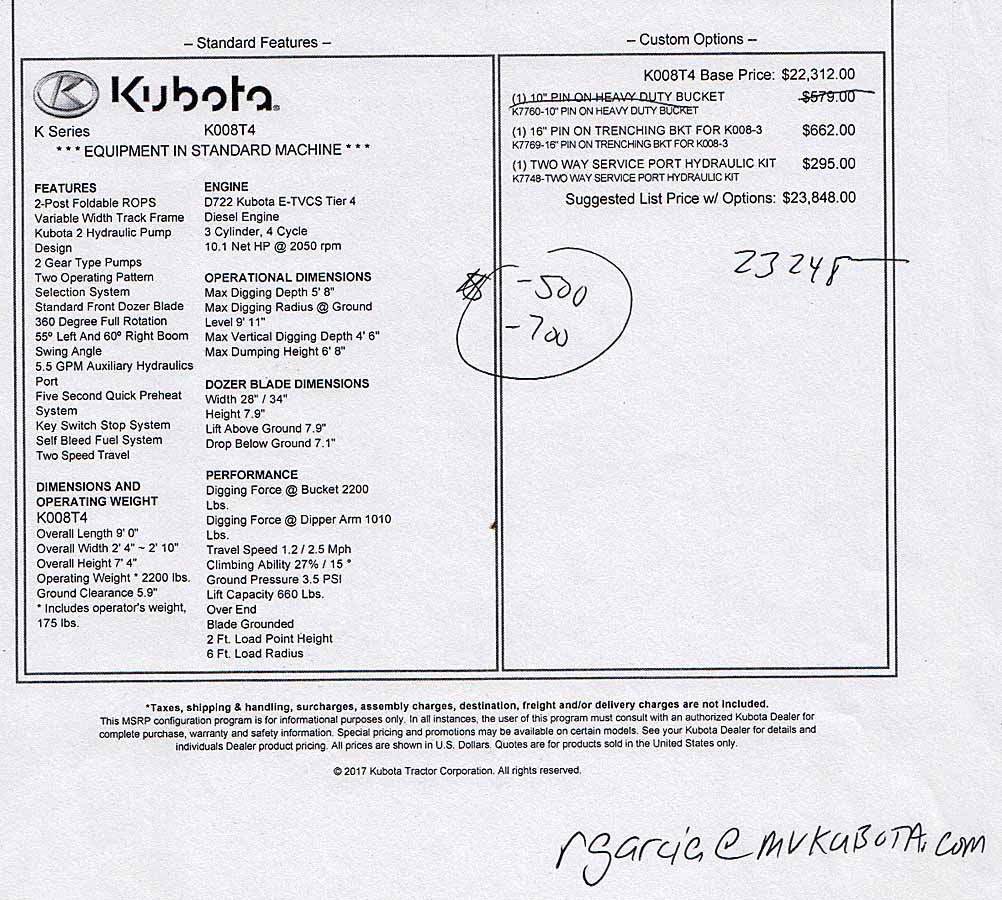

To reduce my manual labor, a tracked machine no more than 3-feet wide is what I want. I
tried a non-tracked machine in the 90s (CADDigger 728), and that was too slow and difficult.
The archetype I covet is a machine like the Kubota K008 or Cat 300.9 one-ton units. I even went so
far as getting a quotation from my local Kubota dealer, and I was looking at about $23K out
the door. (Kubota would prob meet the lower price of the Cat.)

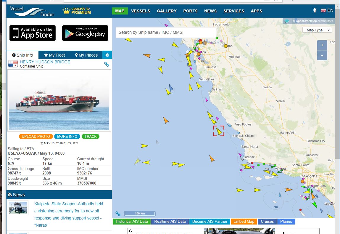

I tracked my container ship as it stopped at various ports on its way to Port of Oakland.
The Alibaba contractor-inspector sent me the attached report, with photos. After 10 weeks, I had my
shipment.
