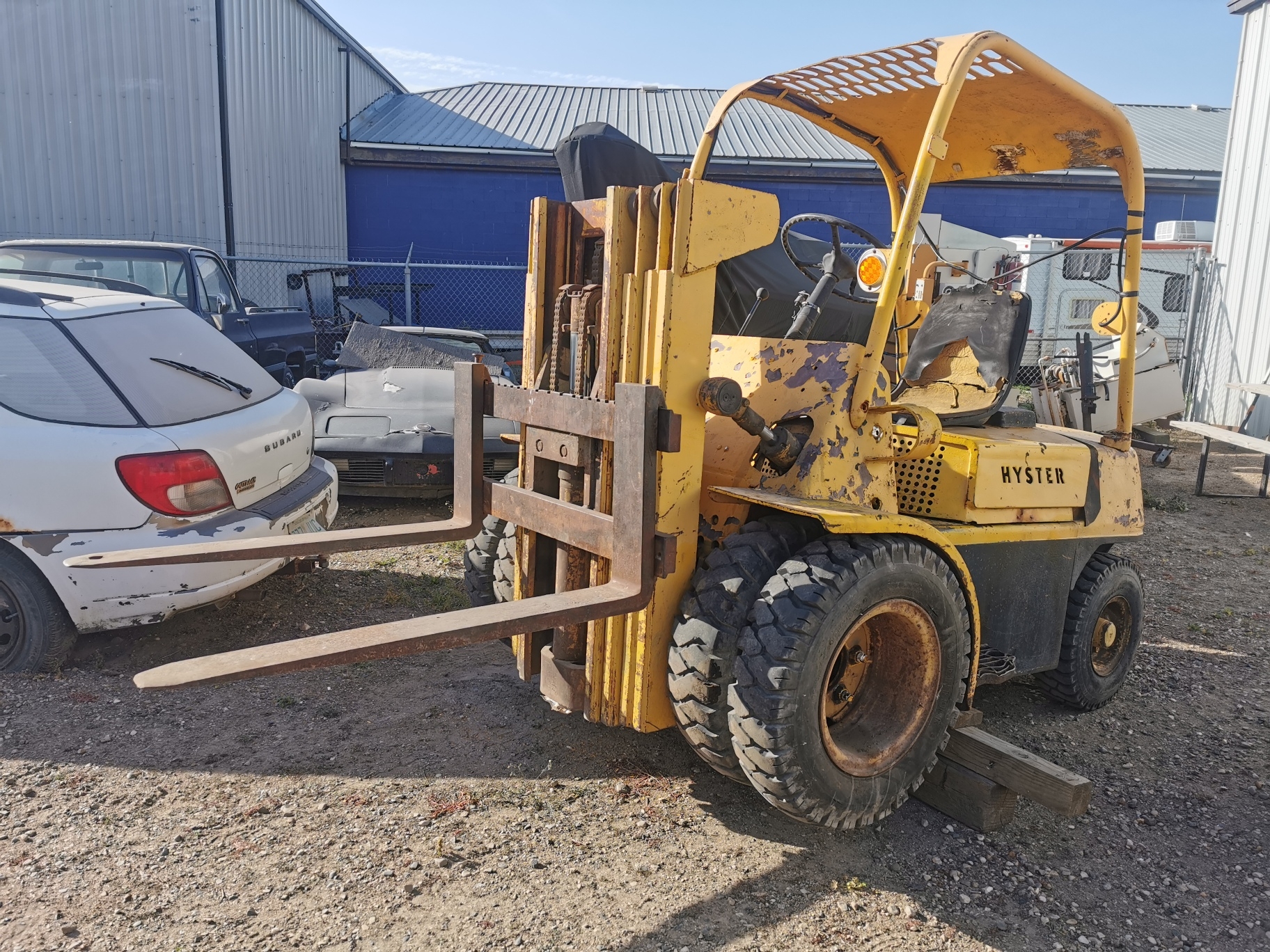

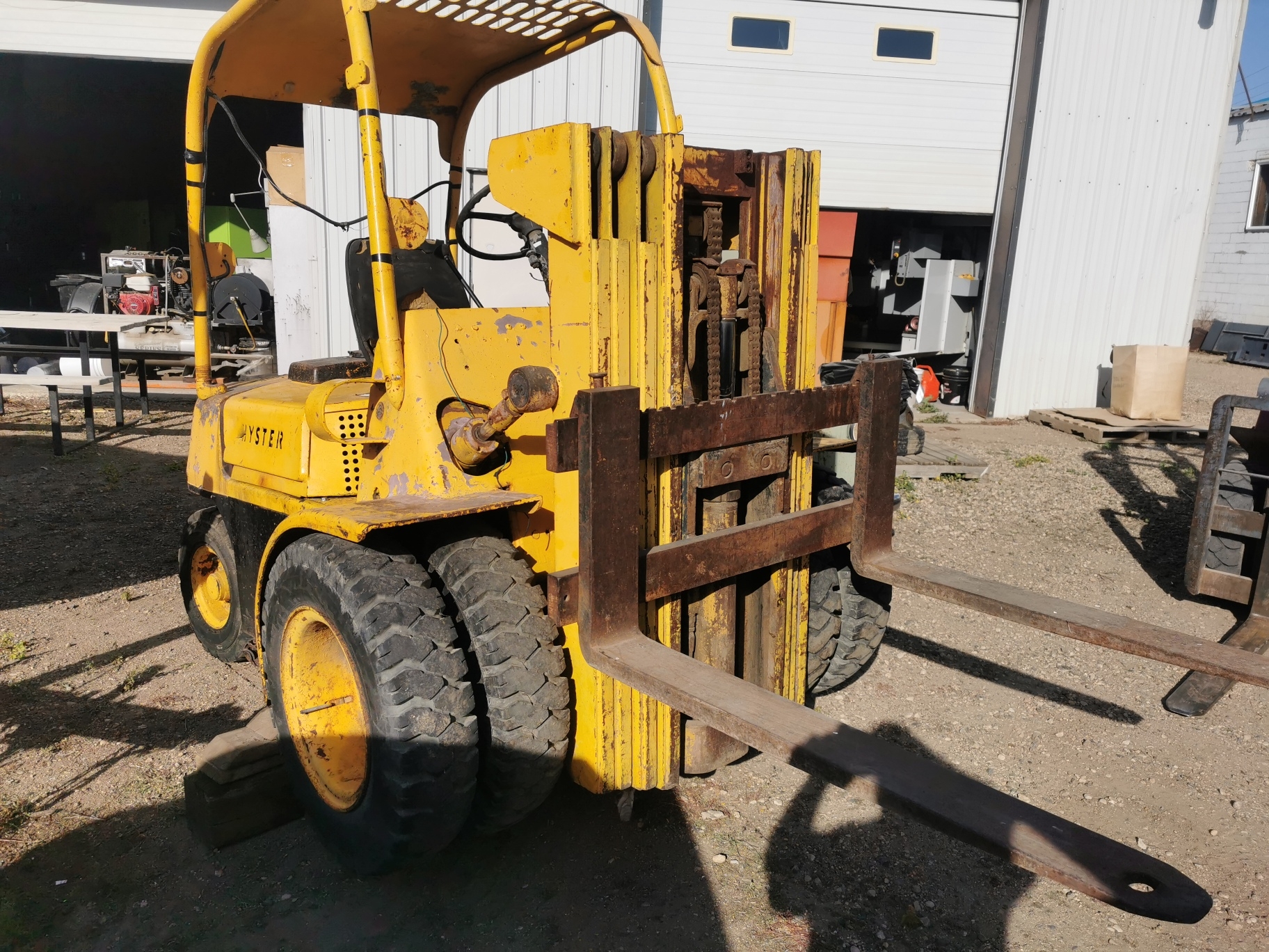

   / Hyster forklift rebuild
#15
here is the forklift brakes adjusted to drag on drums, park brake works fine to lock wheels, once forklift comes in yard will lower it back on ground,
I fired it up to raise the mast and it died and refuses to start, I figure with only 20L of fuel in tank sitting at this angle the fuel pickup is not getting fuel, lets hope

   / Hyster forklift rebuild #16
That should be about a quarter to a third of a tank, it shouldn't run out. Hopefully just a plugged filter from junk stirred up.

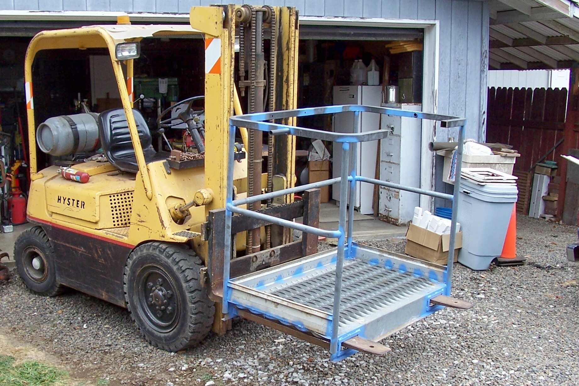

Here's a pic of mine for reference. It's a H50H, 5000 pound cap. Not sure of the year but I was watching old episodes of Honey West a few years back and saw what looked like the same model, brand new.
