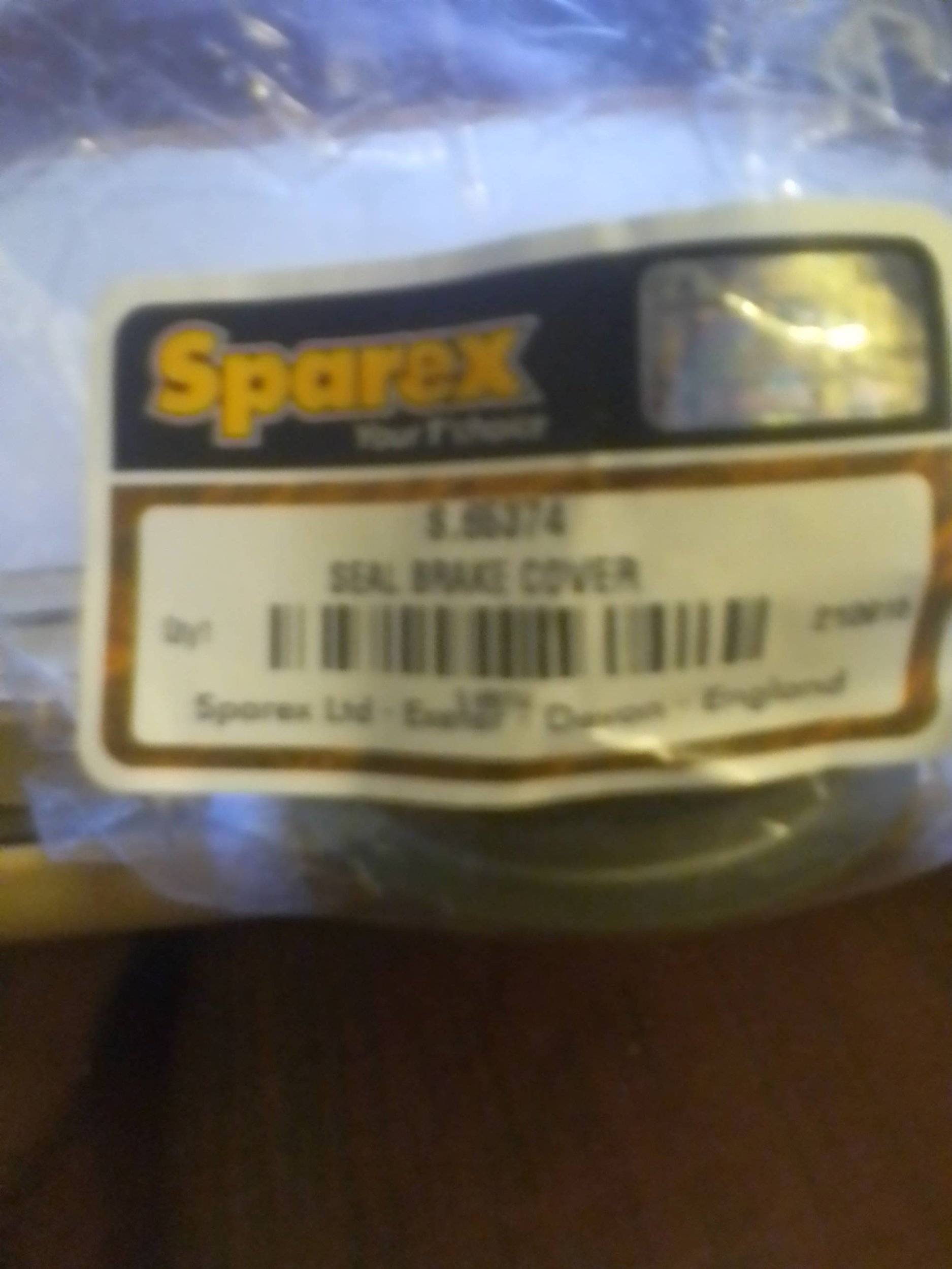

Thanks john0829, There seems to of been what looks like a steel shim thats been fitted inside the hole of the housing at some stage, i removed it and the seal is still not going in, i just keep chasing it around. I get it to the point where its nearly gone in bar about 2mm at the bottom,tap the socket to favour the bottom and it pops out at the side then the top. Ive even got it to that stage and given it a good whack and it ends up bending
Not really sure why you should be having issues with installing in the seal. It should be a simple interference fit. Using a socket or pipe as a driver is the same thing I would do to get even pressure installing the seal.
I would suggest, cleaning the surface really well making sure there is no oil or grease contamination then using a thin coat of #2 Permatex install the seal and let it cure for a few days.
Thanks John0829, It looks like at some stage its had a steel shim placed in the hole of the housing, i removed it thinking itwould make it go in easier but its the same, i get it within say 2mm out at the bottom then tap the socket and it jumps out at the side or the top. Ive even got to that stage and given it a whack but it just bends it. Im wondering if when i order these seals im asking for the right ones. I tell them its for a Ford 4000 1966 Diesel tractor,i have uploaded a few pics. Is there a chance there is two different sizes depending on where the tractor was made. Thanks.

I have encountered seals like this that seemed to refuse to go in no matter what I tried. Ruining more than a few along the way. One way I have had some success with these PIA seals is to get them close to being seated as you said you have with these, then instead of using the socket or pipe use a small/light hammer and wide flattened punch, very gently tapping directly on the area that has not seated. I use an old cold chisel ground flat on the end so that when the seal does seat the punch will also hit the housing preventing the seal from going in to far. Starting near to where it is fully seated slowly work around toward the area that is most proud. Sometimes if your lucky with gentle tapping you can walk the part of the seal that is still proud home.
