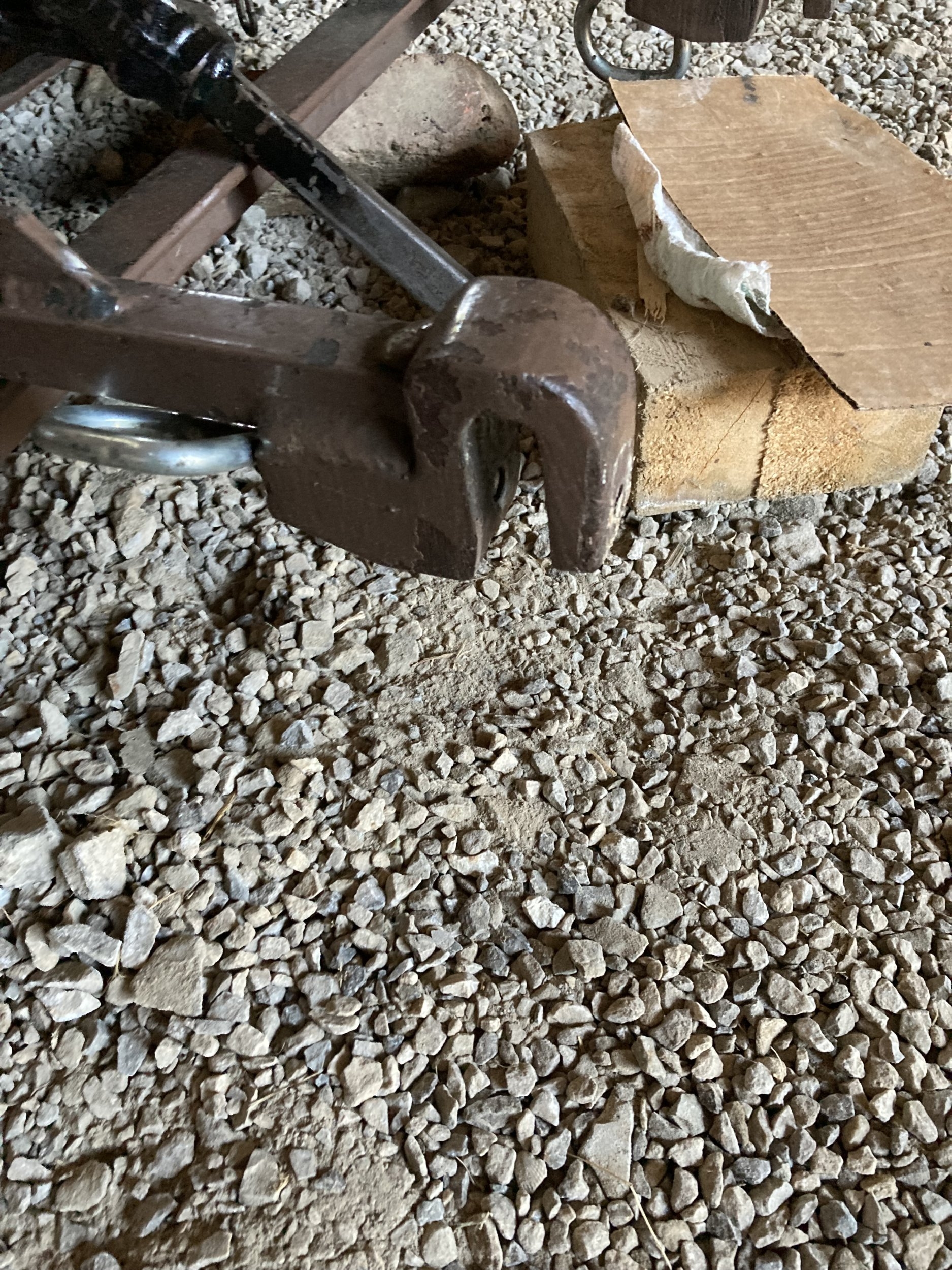

Basically, all GH snowblowers fit all Grasshopper mowers as long as they have the standard attachment hooks up front. Here a pic of those hooks and if your mower has these hooks, the snowblower will fit most anything modern.
Grasshopper only seems to have made two versions of the snowblower and the biggest issue is the way it hooks up as shown above. Mine is actually a late 1990's version but connects just fine to my 2022, 725D.
