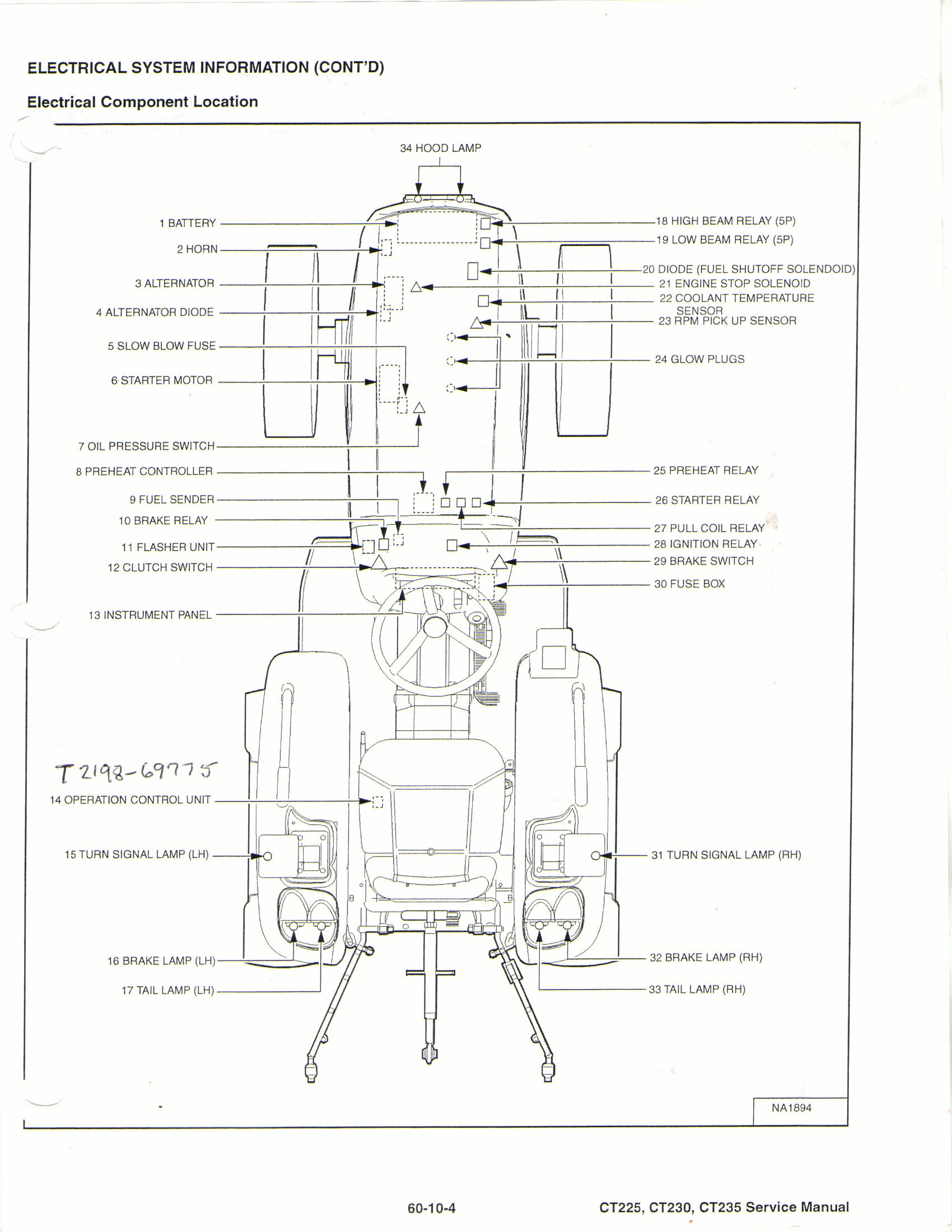

Hi guys!
I turn my ignition on, my 2 Red lites come on, but Not the glow plug lite.
Every so often, turning the key on and off it'll finally turn on.
Luckily its warm, so I crank for quite some time, and she finally fires up.
I've changed my glow plugs about 200 hrs earlier.
It's got 940hrs.
Possibly the relay???
Hiw would I know which one it is?
Any suggestions?
Thanks for your help!

Here is the locations of some electrical. Pretty sure some of the relays are interchangeable. Might try swapping around and see what happens. The sometimes working would made the switch suspicious.

Thank you so much Winston!
I was just going to PM you, asking for this schematic!
Gives me a direct route to look!

WINSTON, do you have a part # for the preheater relay #25

Just a heads up. Some of the listed relay locations in the schematics are listed incorrectly on some tractors.

UPDATE!
NEW Preheater works!
Back in business!
Thanks guys for all ur help!
