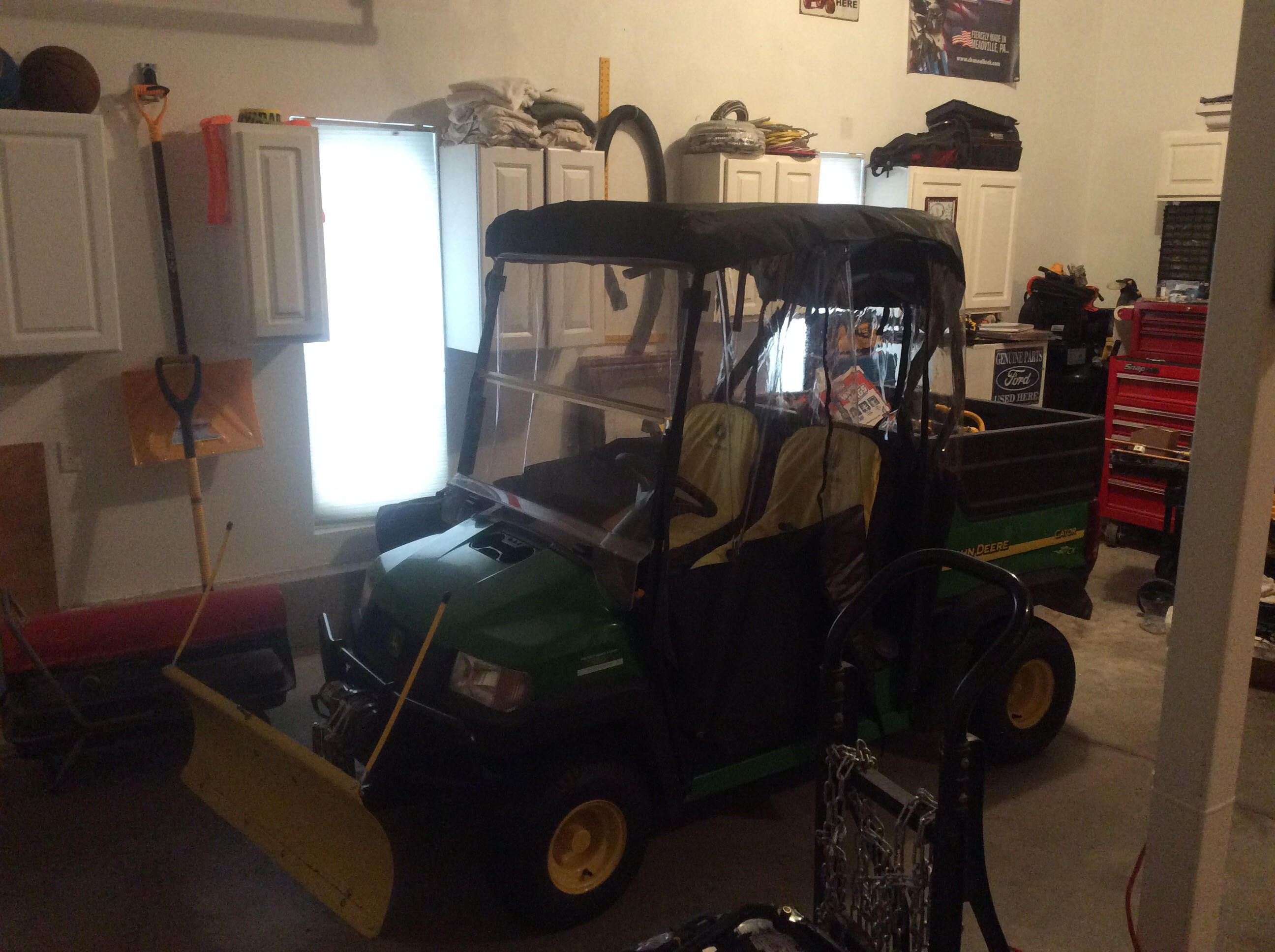

Well I got the plow on my CX and have used it on 6" of snow we got the other day. It did great. My only issue is getting the tire chains to stay on. My driveway is about 1000' with about 60ft of steep incline near the top. With the bed loaded and chains on she pushes snow right up the incline and I wasn't even locking the diff! The only thing I don't have is power angle, but I can live with that for now. I also found a top that fit somewhat.

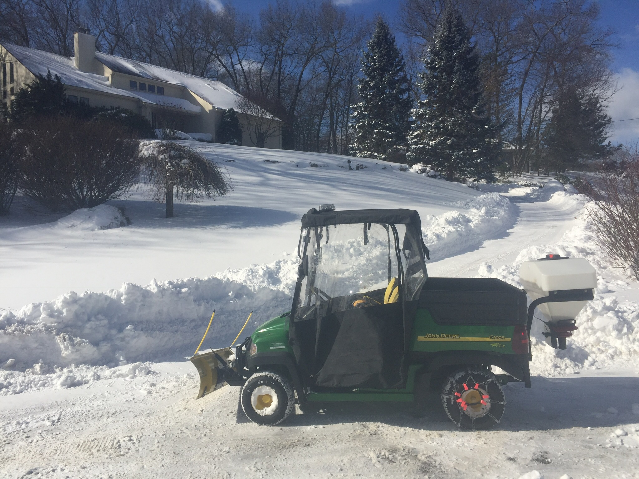

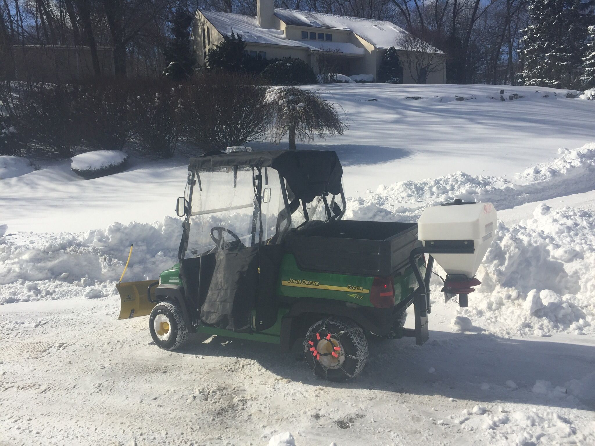

Well a year later and still going great. I don't get stuck because of wheel traction, but rather ground clearance. If it's deep I end up on top with the wheels off the ground. I am talking about the 16" we just got. Anything 10" and under it eats it up. I am looking to get into something 4wd with a Curtis cab and heat. My kids always want to come with me and we drive around a lot too so the bigger machine makes sense. Anyone have a larger machine available? Here's from the 16".

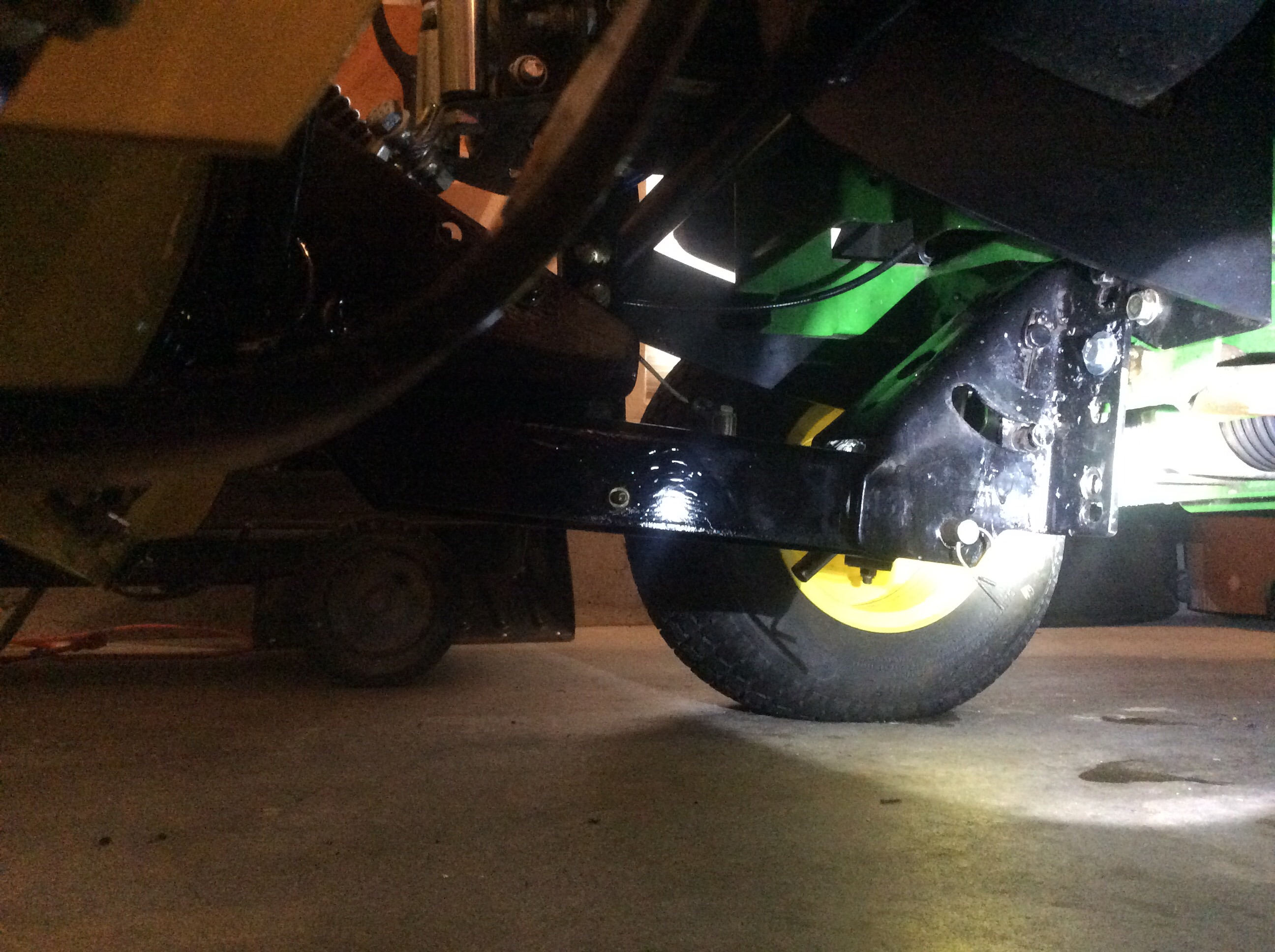

What plow/mount did you end up using? Any way we could get a better picture of the mount?
