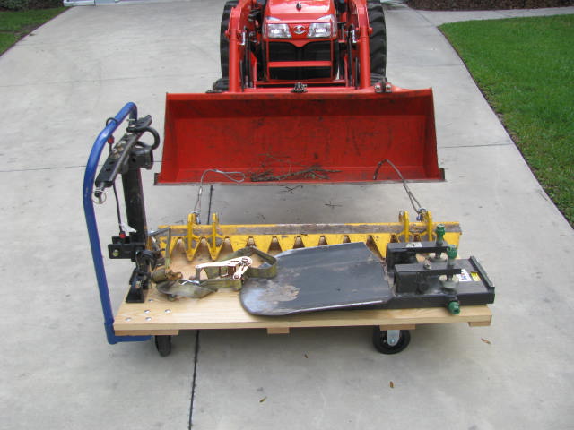

There are an enormous number of tractor implements for cultivating plants. You can cultivate mechanically or use organic mulch. I used large size pine bark, when I had a vegetable garden, before I had my first tractor. As weeds sprout through mulch, mulch is only a partial solution.
On a BX a Ratchet Rake bucket attachment may suffice for 'tween rows cultivation.
