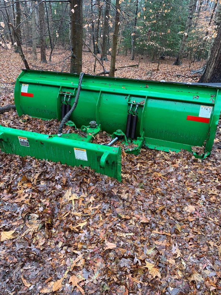

Deere/Frontier 108” wide. Euro/Global attach. Asking $3,000
Has steel edge and a rubber edge. Both new. Looks like it was never used and mostly sat around.

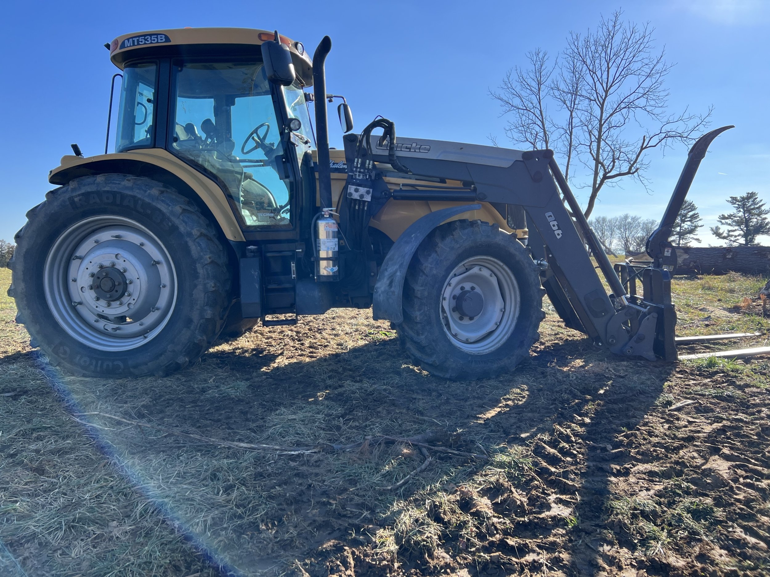

Yes, the Challenger

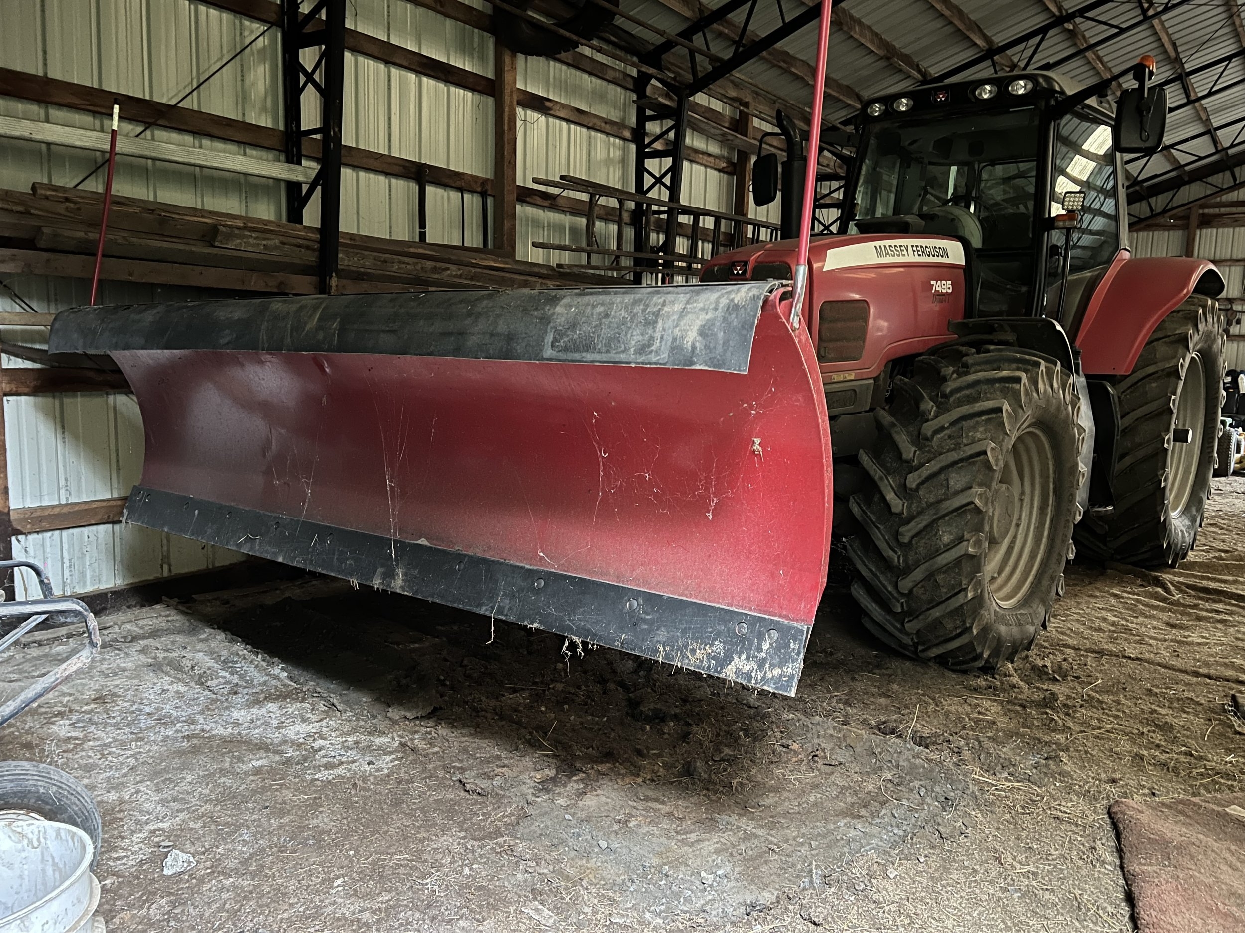

Massey already has the 10 foot “Doomesday Plow”

It's a rigid design though. Right? No way to lower it and let it "float" on its own weight. You'd have the weight of your loader on it too. If it was suspended by a chain and able to pivot on the SSQA plate, it would be much more like a truck mounted plow.
Nice plow that looks new and pretty cheap for what it is. I'd modify it to float up and down from the SSQA plate -- if I was in the market for a plow that size. Is it really better than a buying a truck mounted plow (front end only) and adapting to a SSQA. You have the talent to fabricate and weld and the clevis pieces and weldments are cheap -- Easy to make a plow that pins onto a plate just like it would on a truck.

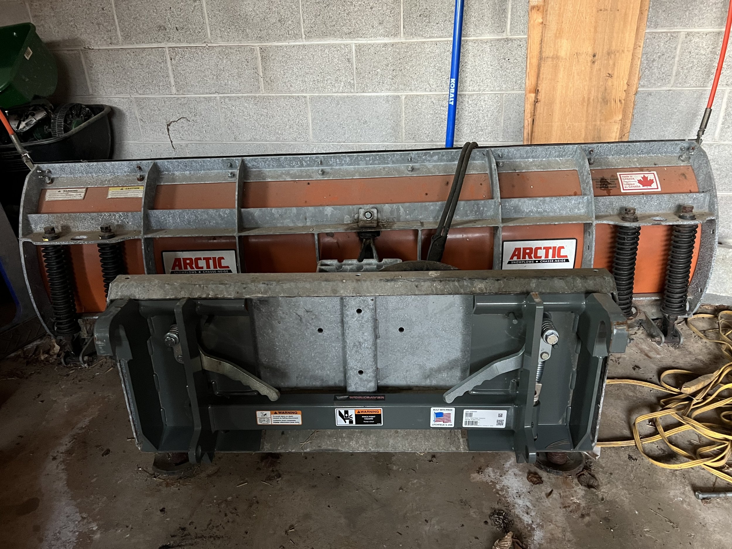

I already have a snowplow for the tractor, but it’s a little small at 96”.
It was mounted to. Kubota M series, but I sold it. The Challenger kind of dwarfs it, but it does work pretty good on narrow driveways.

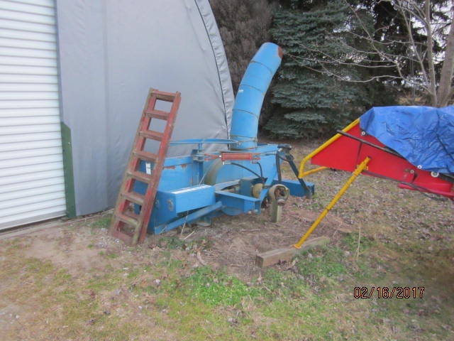

I'd offer 2 if I were you... 2 years ago I happened on a 10 footer on the side of the road already mounted to a SSQA plate with power angle cylinders and hoses and I offered the seller a grand and got it. I did have to replace the wear edge but that was it. Problem is, it will plow steer my M9 without chains on the front tires and it's heavy too. I also added wheels to the bottom, replaced the skid shoes and I have it set to just skim the surface and no more. With the big Lucknow Blower on the back, it's basically unstoppable.
