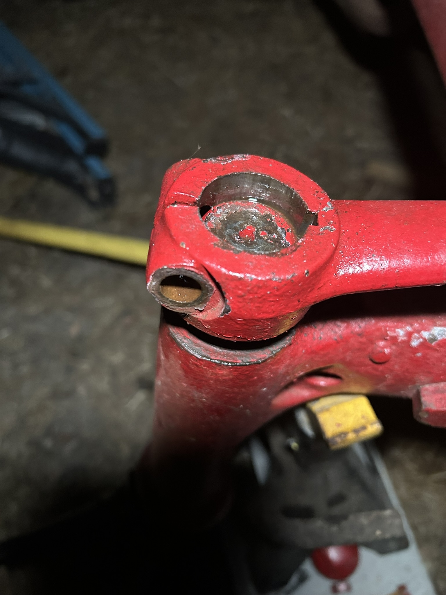

I recently bought an 8N that appears to be a 1949 based on SN. I disassembled the right front hub to check the excessive play and found both bearings to have been completely disintegrated. Thought to check the left hub to see if I can identify the bearing sizes and type, and surprised to see the 2 spindles to be entirely different.
I don’t have much info about what has been done to the 8N, but would appreciate any info you have on the spindles and rebuild kit for the right hub (picture attached). Thanks in advance.

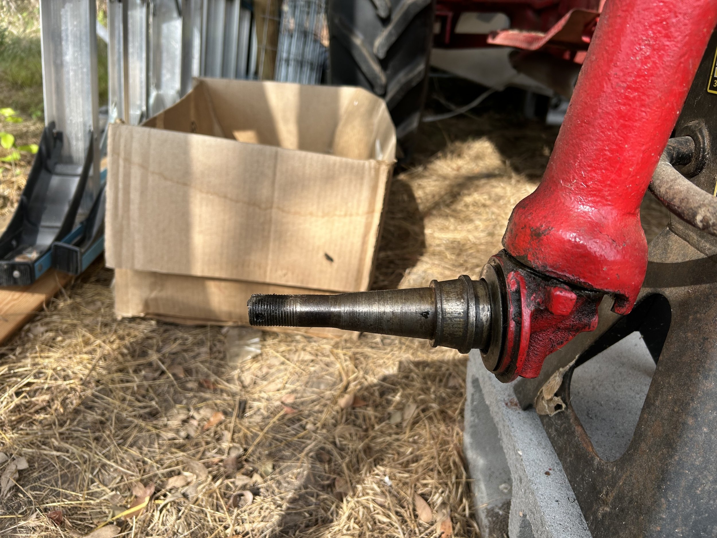

Thanks for the link to the replacement, EdGooding. I've tried to take the old spindle out but got no luck. It seems stuck really good to the spindle arm and no amount of hammering seem to move it past halfway point (see the picture below). Any particular trick to get the spindle off the spindle arm?

Beating on it will not work, it is keyed and will not go any further down until you remove the key. I usually just use a jaw gear puller to get the arm off the spindle then you can remove the key. If it like most I have seen the spindle will all but fall out then because of wear in the bushings.
