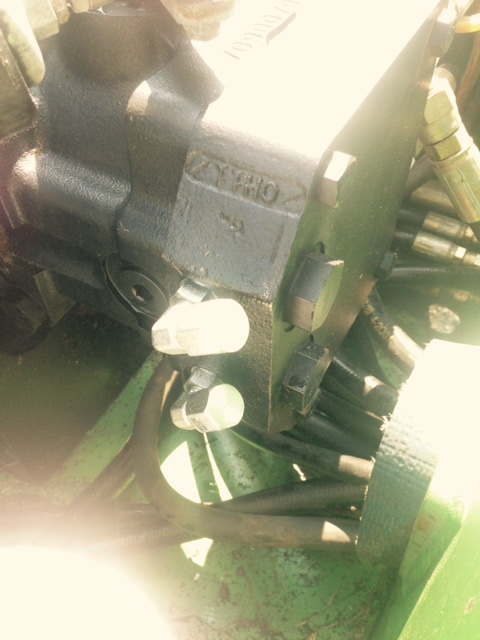

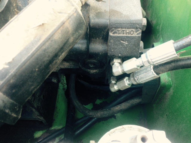

Decided to weld a nut onto the broken stud and use a wrench to back it out. But didn't want to weld in the garage and didn't want to weld with a tub full of grass clippings and debris. Can't move machine without opening tow ports.... never had to two mine before. Manual says to open the tow ports and connect the bleeder hose that was supplied with the machine.... the bleeder hose only has one fitting. The other end is just a cut hose. I know where the bleeder port is, but can't locate the fittings for the tow ports that the manual says are on the side of the tram pump. Finally figure out the tow ports are just plugged and there are no fittings installed on them for the bleeder hose to attache to... IF the bleeder hose had fittings on BOTH ends, not just one end.... Ouch!
Decide that I need two 90 degree male-male fittings, two caps, and one female fitting on the end of my bleeder hose. Head to NAPA store.

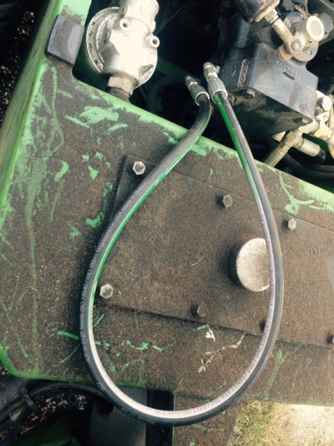

I install the fittings, the hose, put a ratchet strap on the FEL arms, lift it up an inch and am able to very easily roll the tractor out of the garage.

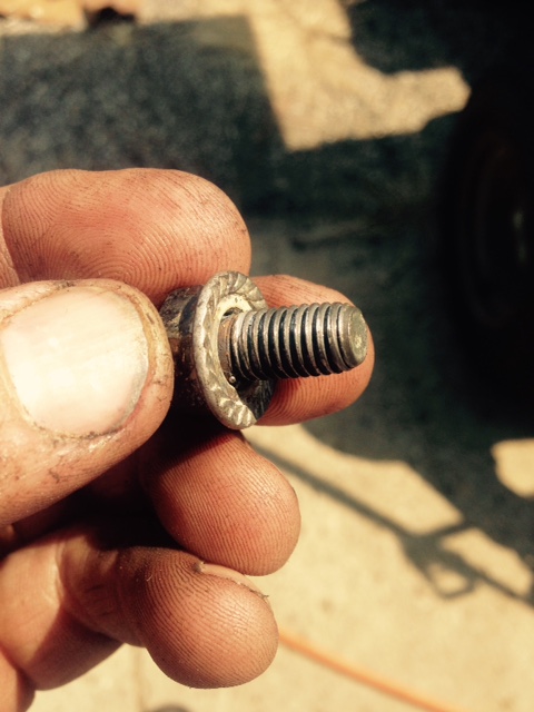

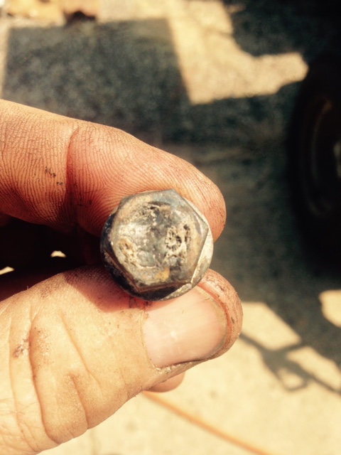

Put the oversized nut on the broken stud. Roll out the wire feed welder. BZZ BZZ BZZ BZZZ BZZ the nut is welded to the stud. Backs out easily with a wrench while its still hot. Worked great!
