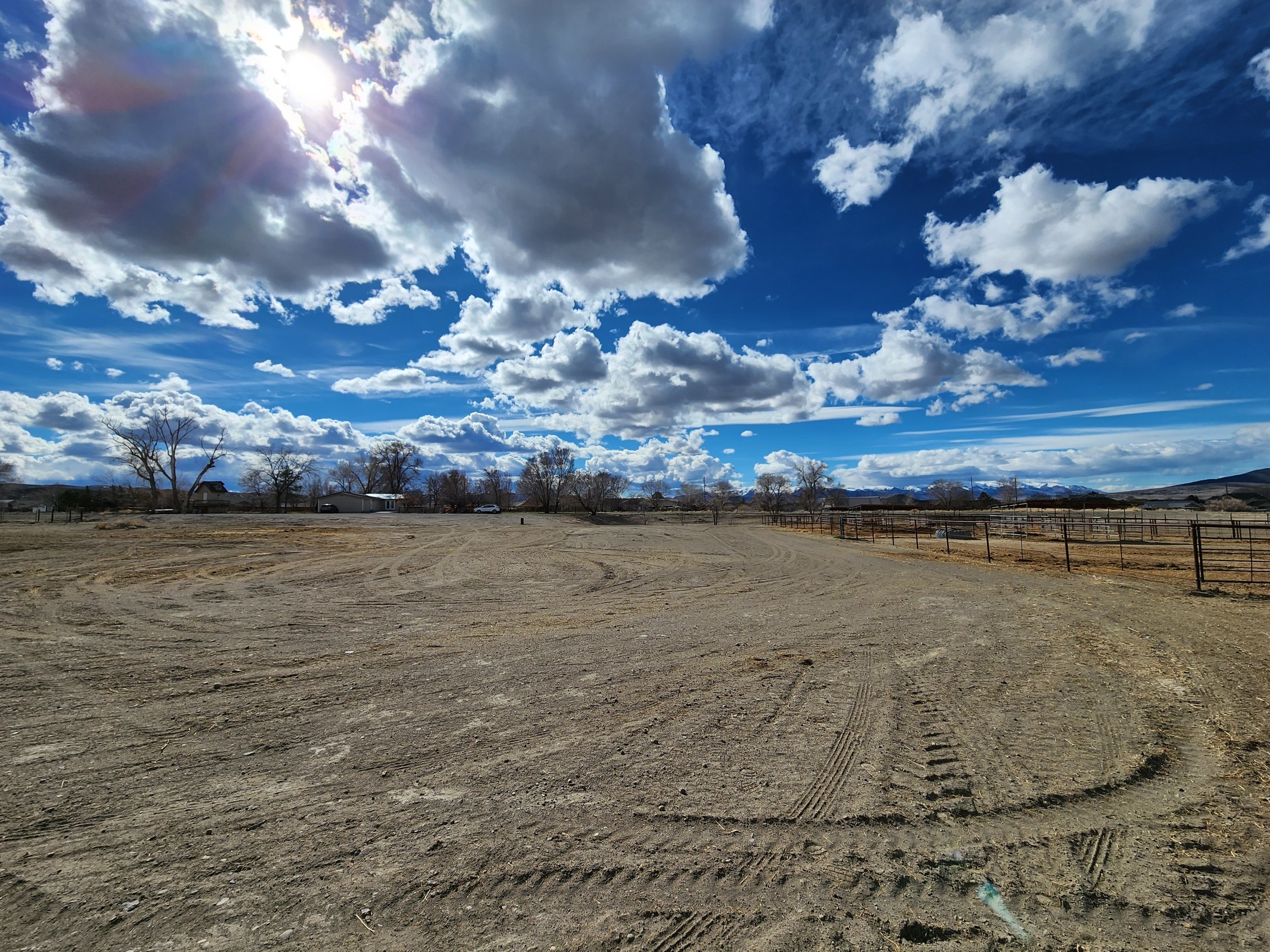

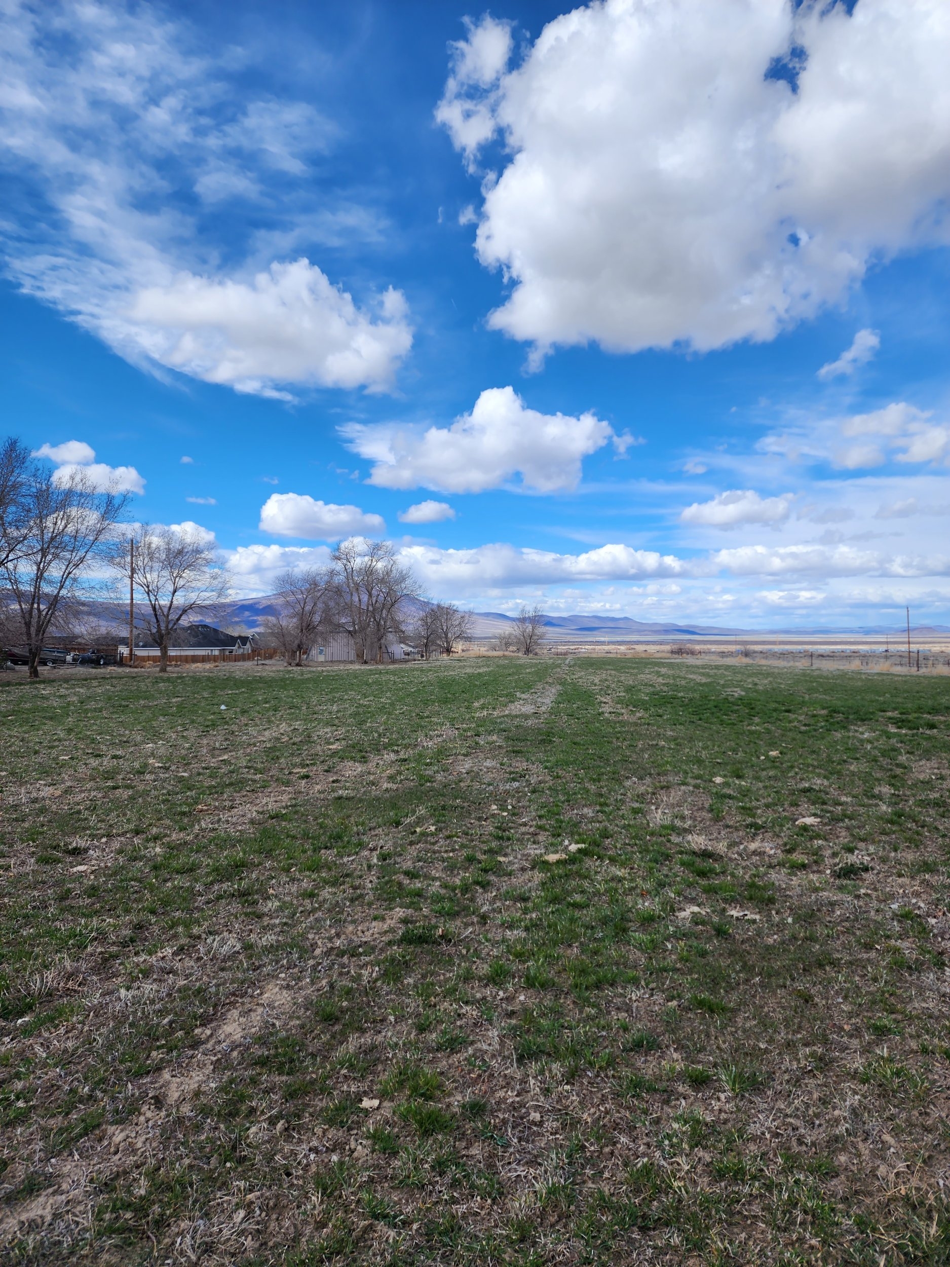

Last year we purchased a 10ac property in northern NV. I have approximately 2ac of alfalfa that I would like to get rid of, several fruit trees with more on the way, and plenty of weeds to battle. I also have several unused corrals so were also looking at adding large animals other than our chickens once were a little more established. Luckily I have an awesome neighbor that let's me borrow his MF 1835M but I definitely need my own tractor.
Price and emissions has put me into the sub 25hp market and I have narrowed it down to the CX2510 vs the CK2620. I'm looking at around the same price for each but the 2510 would include the FEL, box blade, 3rd function installed, and a grapple. For roughly the same cost I would get the 2620 with just the FEL and box blade. The price for each is the max im looking to spend. Would it be worth it to just get the 2620 and add the grapple down the road or would the 2510 be sufficient? I just have this feeling that the 2510 won't be enough for ripping that alfalfa field and that I'm going to find that the loader capacity isn't enough. Am I just over thinking it?
Pictures of land for reference.
