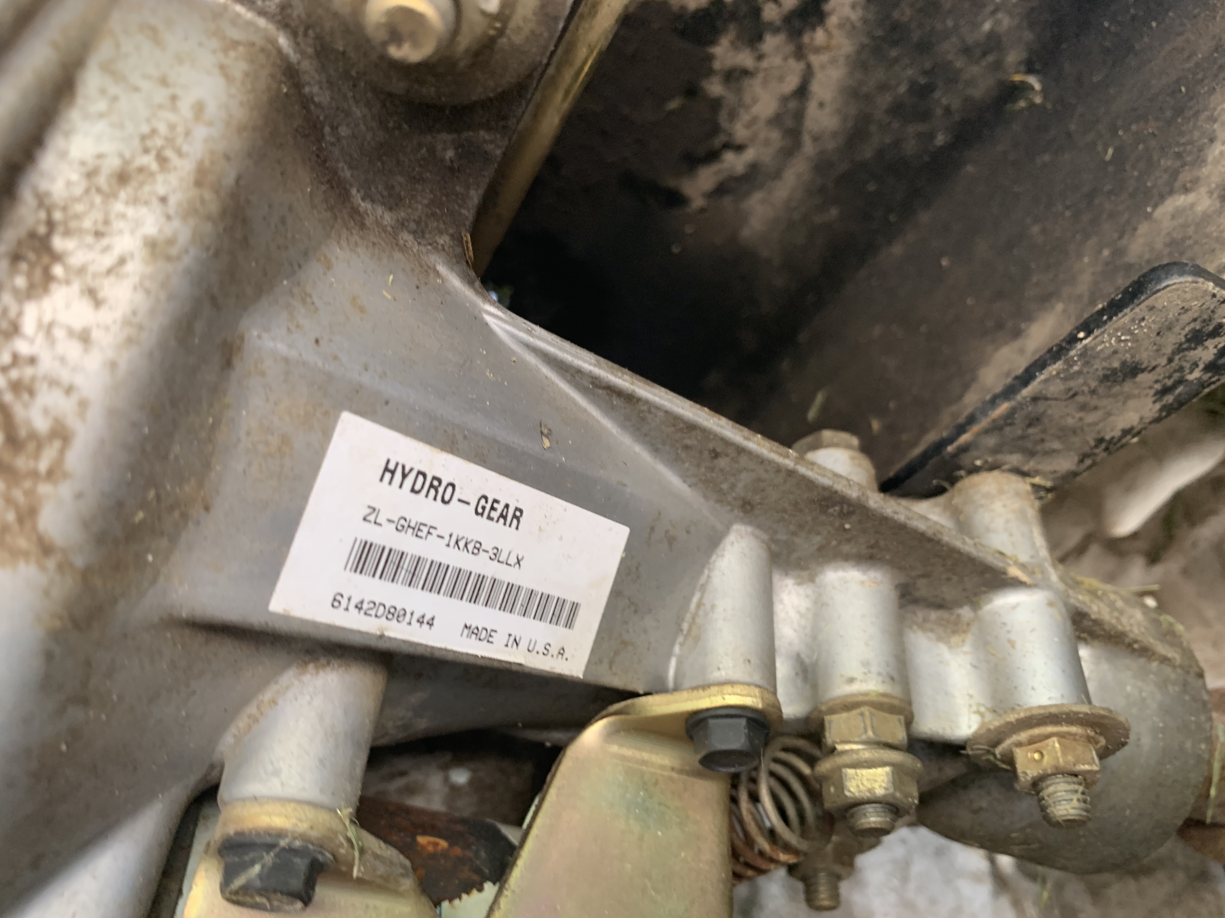

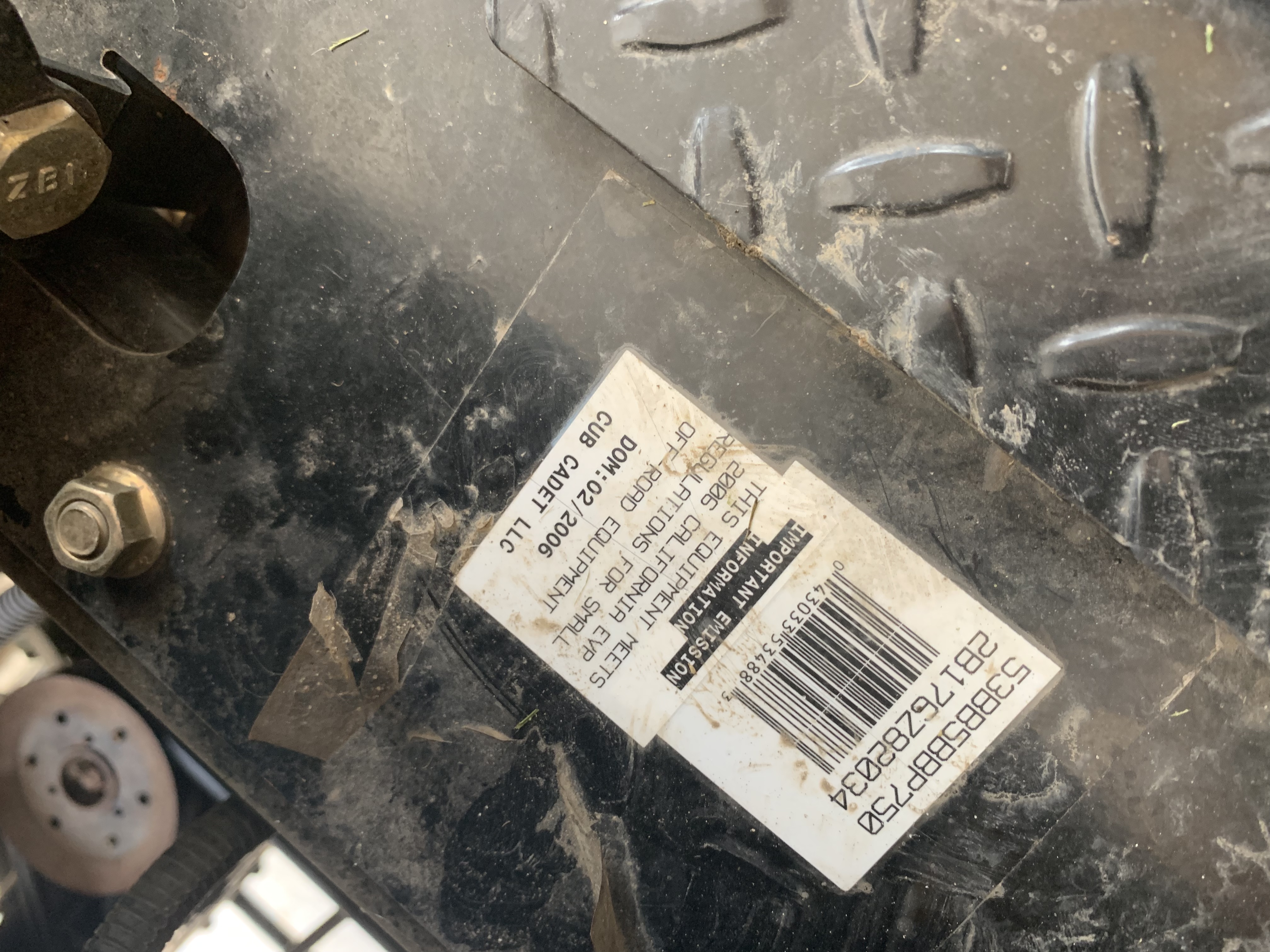

I have a cub cadet m50s tank . I知 having issues the left side hydropump . I believe it has the zt-3100 hyrdro pump brand transaxle. The issue I知 having is lack of power on the right side when turning and in reverse . When I知 going straight and even going straight up an incline it痴 seems to have even power . It will also get up to full speed when going straight and doesn稚 pull to the left . And it also seems to be better when it痴 first starts running , like the first 20 minutes . I致e replaced all the belts and nothing . I haven稚 done a oil change yet , but wondering if that痴 worth it. Could it be the pulley on the trans being worn out ? What should I check before I take the trans off and rebuild it or get a new one. Could bad oil cause this issue ? And if I rebuild what is it likely to be ? The center section ? Any help is appreciated. I included pics of the model number of the tractor and trans

You have a ZT-2800 transaxle in early stages of failure. Changing the oil may help for a short period of time but will not be right and may not last long. As a Hydro-gear dealer I have never seen one where you didn't have to replace the pump, center section, and the motor all at the same time. Even had to replace the charge pump and transaxle closure plate because of scoring on the last one I did. Any grooving that you can catch a fingernail in when ran across it has to be replaced.

I致e seen videos where people wet sand the flat side of the pump /motor and install just a new center section , any chance that could work ?
   / Cub cadet ms50 transaxle hydropump #6
Are you sure that you can get all the sanding grit out of all the holes and edges inside of the pump and motor. This is a procedure that any contamination can destroy any work that was preformed in just a few hours. And depending on amount of damage could require removing .030 or more from the surfaces,and any material that is removed from the part will change the distance that the pistons are moved when in operation so you will loose speed which could result in tracking issues.
