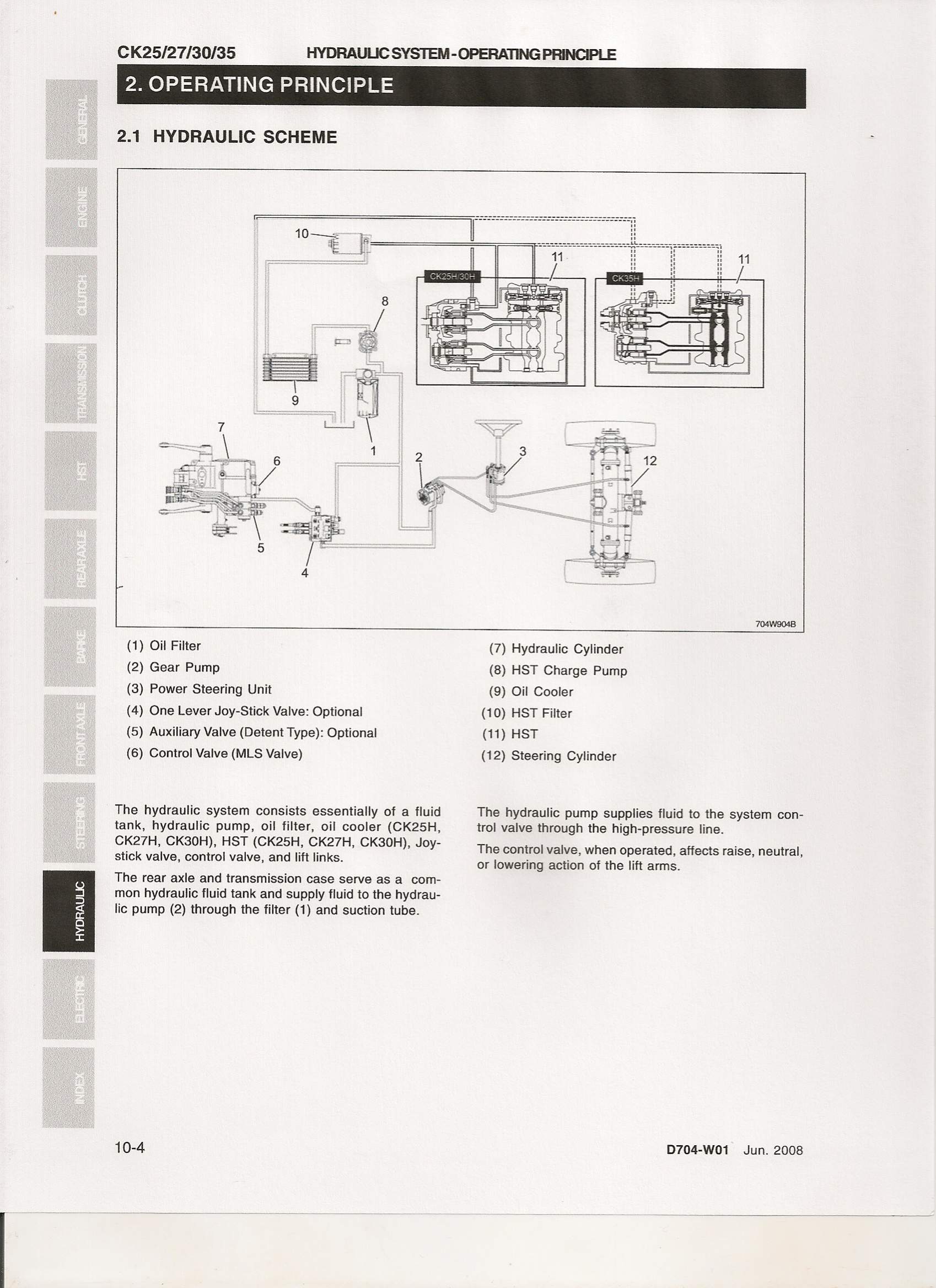

Oh! If that is the case I believe power beyond is already being used on the loader valve. You will notice it has 4 loader lines and 3 other lines. I'm not sure of anything but believe the line going back toward the 3 point is the power beyond outlet.
I believe the rear auxiliary ports would be the answer to a 3rd function.
Note this from the CK35 manual, same as your CT235. You may not have the loader valve (4) or auxiliary valve (5). Both would appear to have power beyond in use.

Winston1 is correct. Power Beyond is already there being used. It is the extended fitting coming off side of loader valve with the larger steel connected going back to 3 pt.

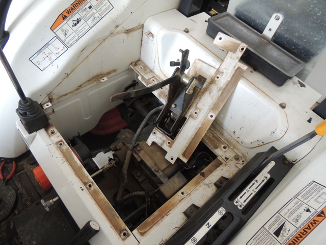

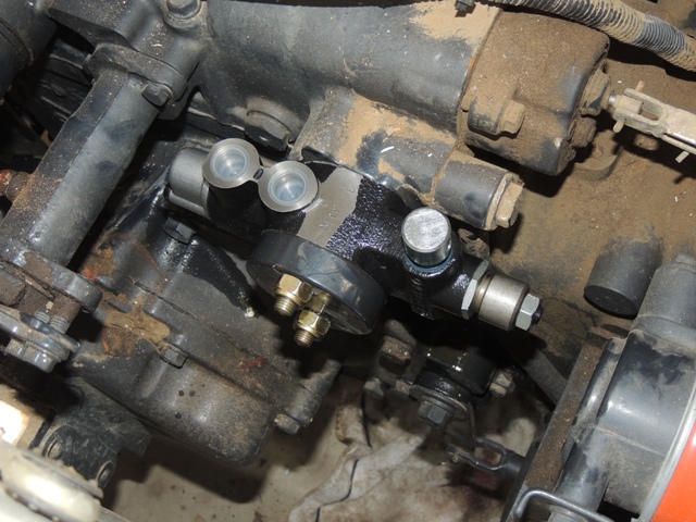

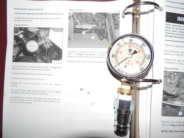

Thanks again to every body. I got the remote kit from Bobcat installed with only a couple problems. The biggest one was the seat. Man is that sucker heavy! I advise anyone to separate it into two sections before you lift it out of there. It's a lot easier to handle that way. The other one was mounting the Bracket for the connectors. The plastic plugs by the fill tube had deteriorated and the base of the plugs were stuck in there. The rest of the installation was a breeze. I made up a test gauge from parts from the local Parker hydraulic shop. It tested fine up to 2500 PSI and no leaks! From those of you who have already done this - any idea the length of hoses I will need to run the hydraulics to the front (loader cross bar)? I'll try to post a couple pix.
