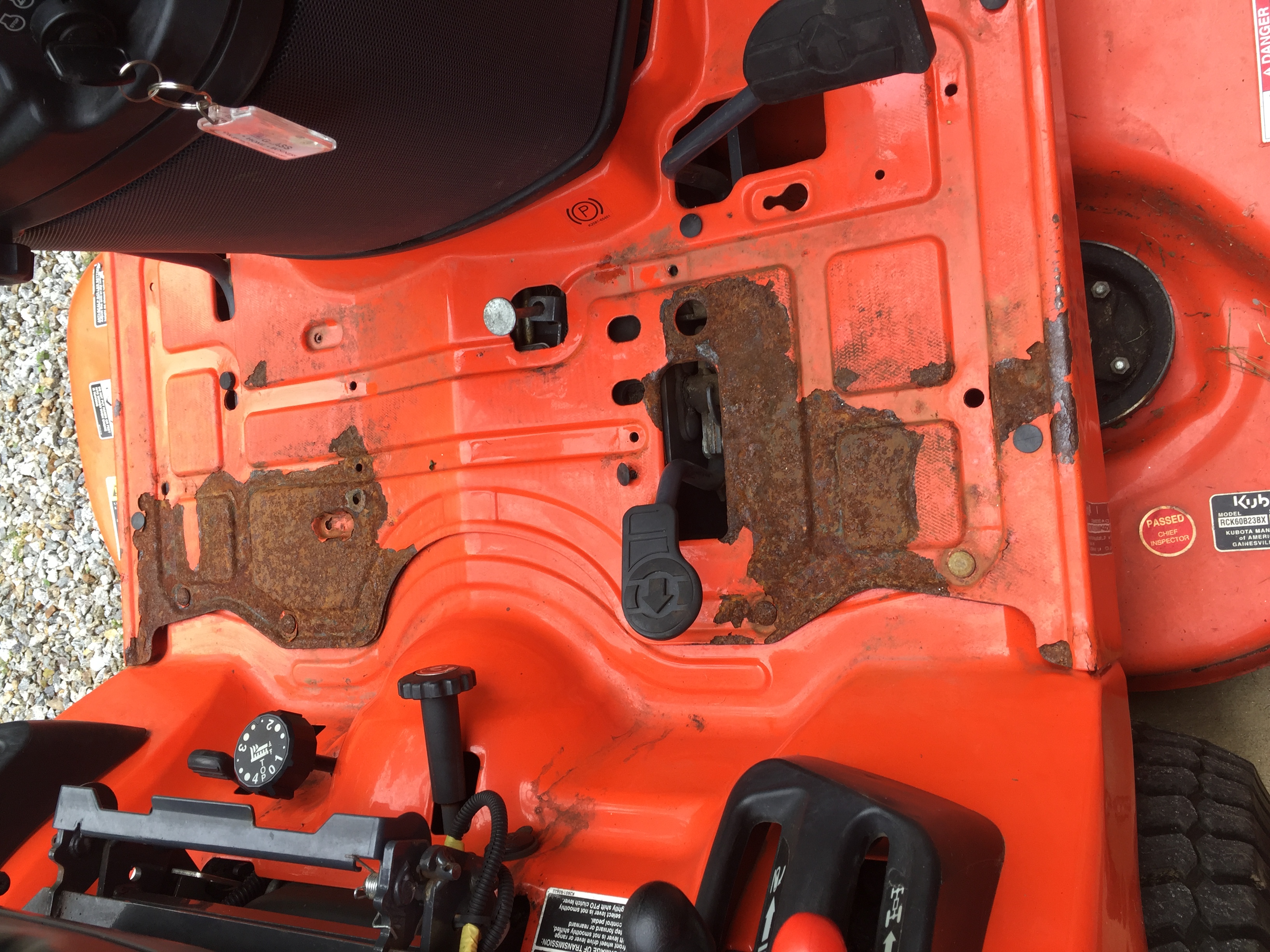

Does anyone have a part number for a BX25 floor pan? Mine is rusted out pretty bad and I'd like to simply replace as opposed to trying to fix it... thanks

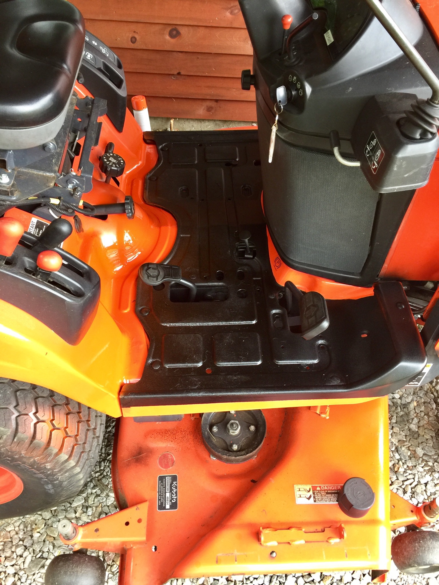

For about $15 you can do what I did with a scuff pad on your drill and a can of bed liner.
Before and after.

Thanks... I'm going to give that a try at least for now. Mine's in pretty rough shape with rust starting to go completely through with open holes. However perhaps I can salvage it as opposed to spending about a 100 bucks!! Thanks again.. yours looks excellent....

Back when I bought my L3700SU, if had a plain painted floor board, no rubber mat. I removed it in the first few days as well as the step and center cover..and had them sprayed top and under with Linex....still looks like day 1.

Thanks! Maybe you can pop rivet some sheet metal over the part that is rusting through?
Then give it the scuff and liner treatment. Probably last 10 years or more!
