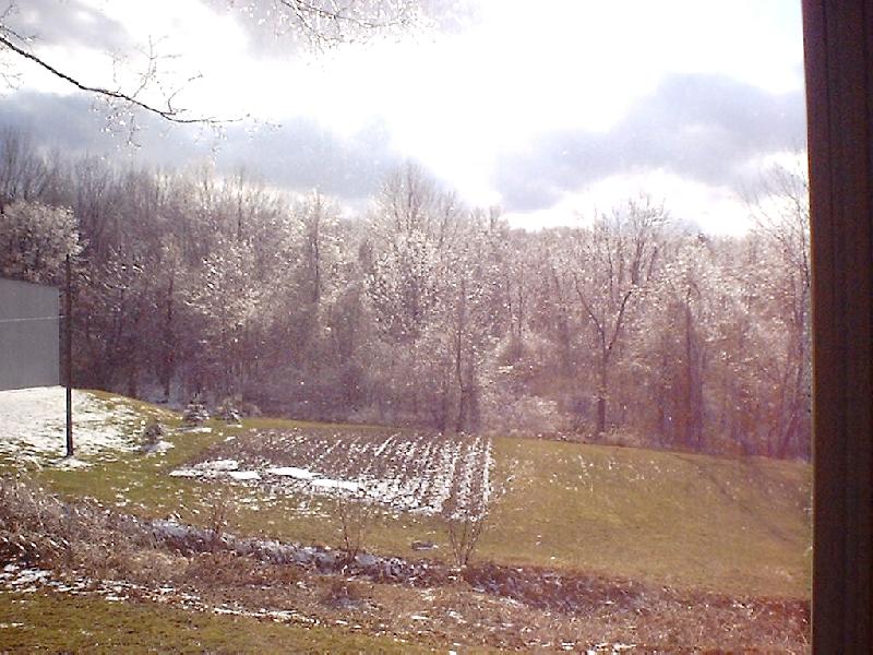

Thanks for the input, guys. It looks like both serve very useful functions. I'm still not sure which will come first, but probably don't really need either until spring... maybe.
I sure know what you mean, Frank, about the arms and legs - and neck too. The old Ford is a wonderful machine, but... I had fun with the "bush hog" mowing backward to a creek and slamming on the brakes (what brakes?) to keep the blade spinning a couple of extra seconds. And driving into a tree on my side hill to stop when the brakes weren't damp and grabbing. I'm sure enjoying the power steering, HST, live power take-off and and a 3PH that you can put where you want it and it stays.
A fellow just brought me a check for the 2N an hour ago, so maybe, just maybe, I will be able to get both a box blade and a tooth bar before next spring. The idea was to help pay for the 4100, but...
I'm going to try an attachment that shows what that 4 acres looks like. It's the stuff beyond the garden.
