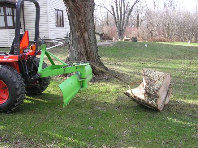

</font><font color="blue" class="small">( Got a point about safety, I just got a new RB and the manual has all kinds of warnings about fastening onto the frame and using it for pulling. Common sense alone tells me not to use an attachment in this manner, but to pull from the drawbar. )</font>
I went back and relooked at Frank's picture after reading this. I agree with the comments on keeping the hitching point low. Fortunately the ground looks fairly level. If the load had been heavier, or had snagged, with the way it was hitched, I suspect the front wheels of the tractor would have come off the ground. I understand why Frank hitched it that way, it kept the front edge of the log from digging in which probably would have been worse. I probably would have hitched it the same way. another way to move loads like that is to partially get them in the bucket lift about an inch off the ground and push them. Doesn't gouge the ground any more than pulling them. If you can 't lift the load, drive into the log with the bucket a couple of inches off the gfround and curled down so that the log goes into the bucket. Then curl the bucket up to lift the load.
