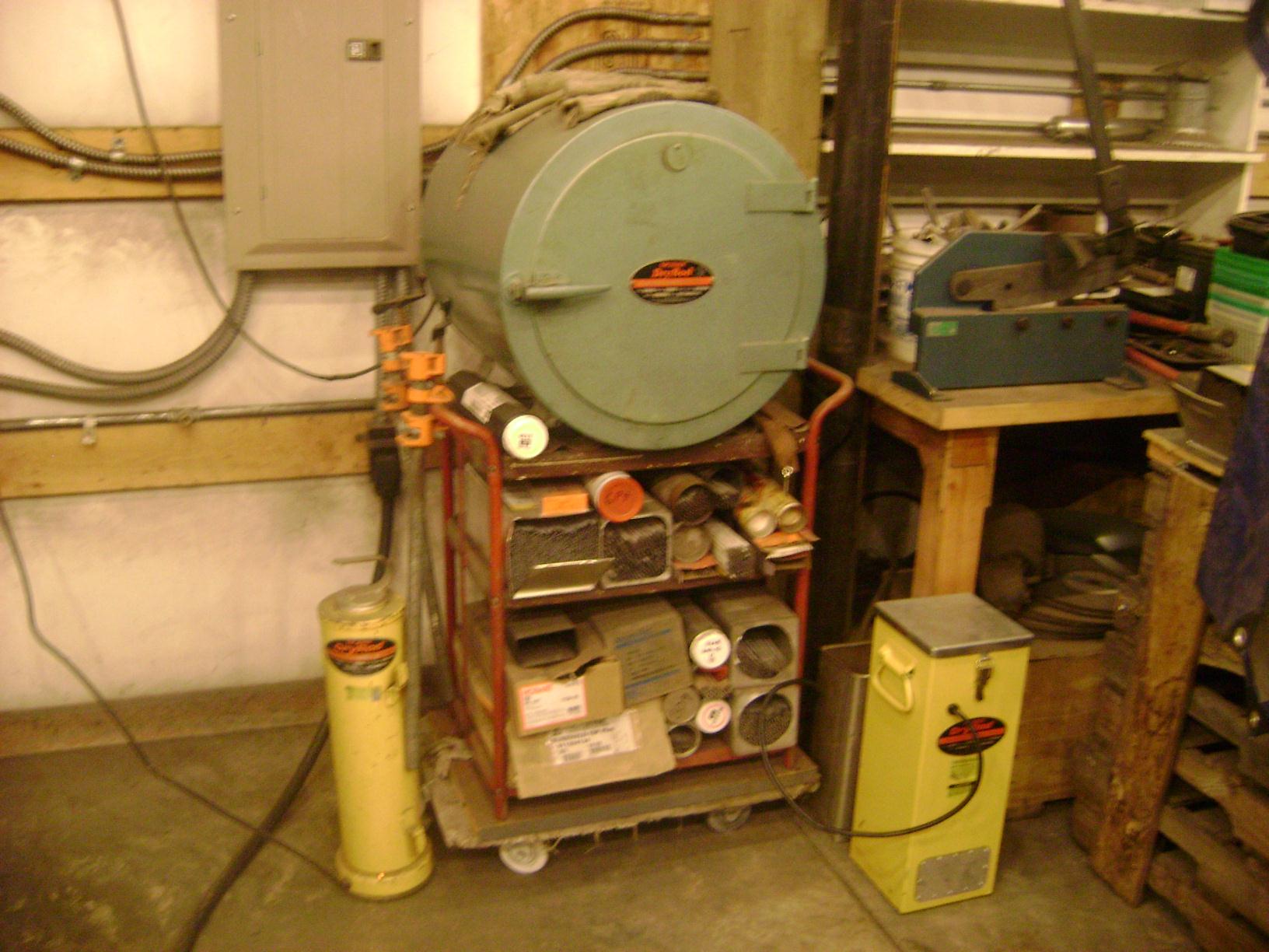

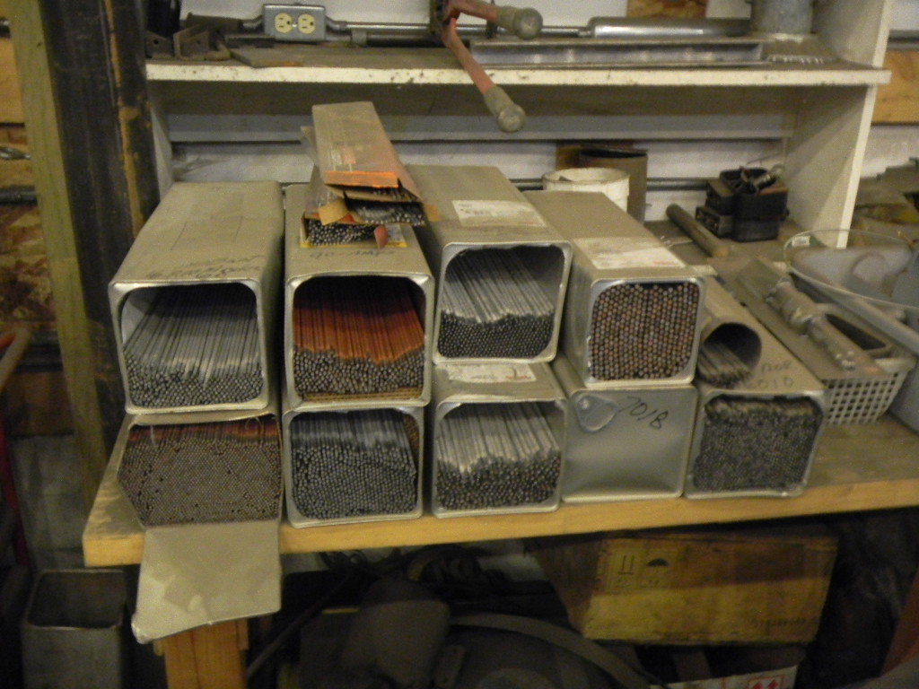

Any low hydrogen rod should be stored in an oven if you're working to code. 60XX rods should be kept at room temperature. Never done it to 6013, mostly because I don't use them much. But my 6010, and 6011 rods will dry out on me. They burn off to one side or finger nail. I'll dip them in water and let air dry for a day or two. Then good as new. ;)

I do not work to code with 7018 but I do use a rod oven for my 7018.
I am not a professional by any shape of the imagination but I can tell the difference between a 7018 rod from the oven and one that is not. They burn differently and the flux chips off differently after the weld.
   / 'Baking' Rods #10
