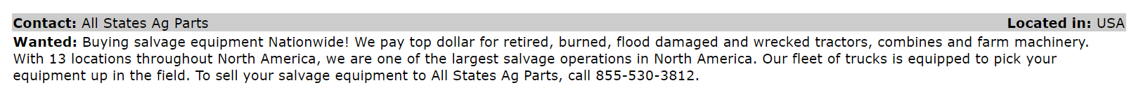

If it was my broken tractor I'd call the number below or some other salvage yard.
