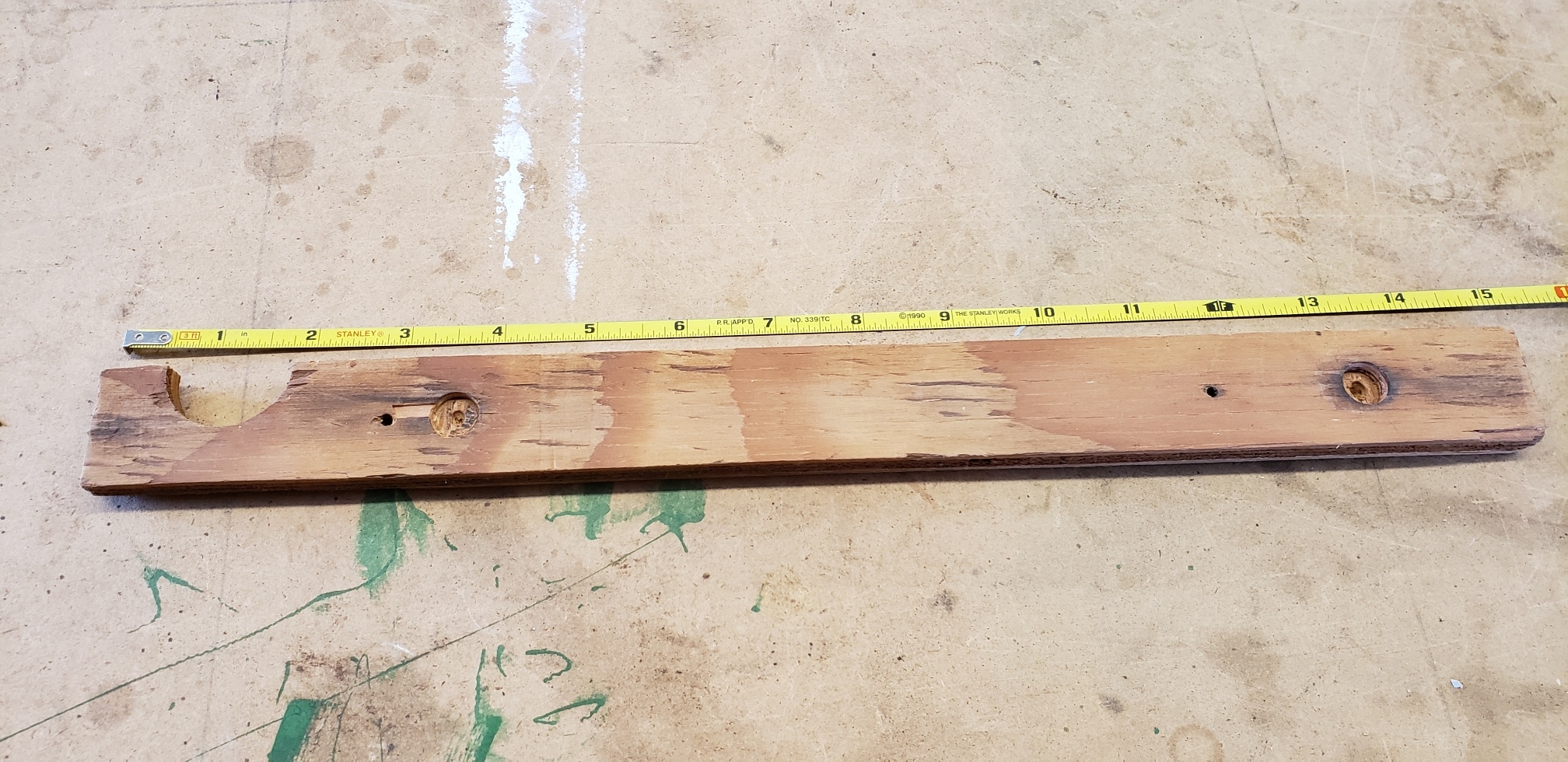

My jd 2720 has a lever like the one rScotty posted earlier. I made an extension out of .5" plywood to raise and lower the front wheel assist lever. I also glued on 2 magnets so it will stick to the ROPS to be handy and yet out of the way.
The 1.25 cut-out near the end makes it possible to push/pull that lever.
Question, why do they put that hand-only lever so far away from our hand?
