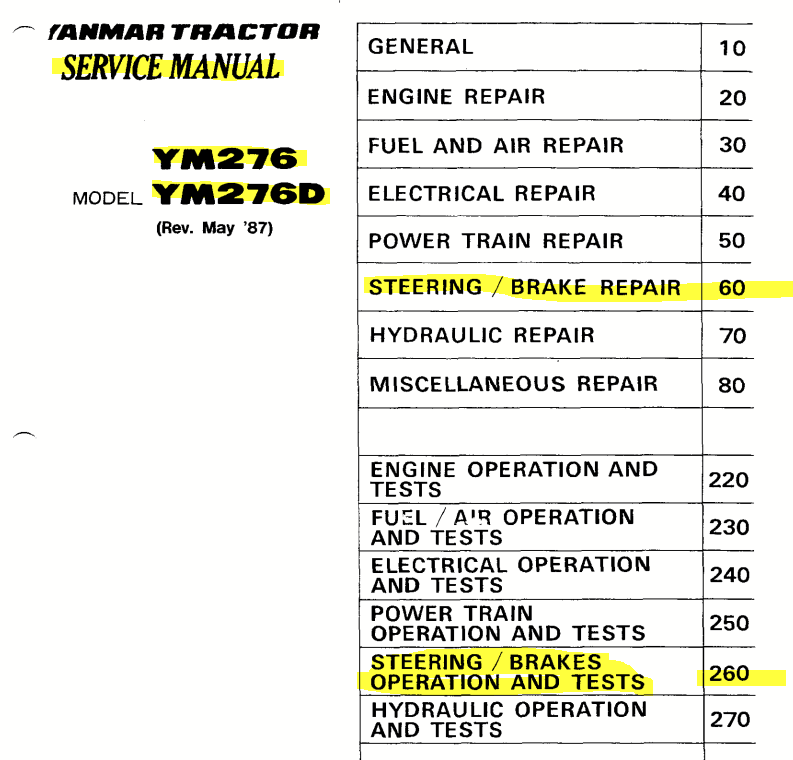

Hello everyone, ym2210
I've have about 9" of play in my steering wheel for 5 years now. The play in only in the steering wheel, and shaft. it's not spinning loose on the shaft, so that would be the wheel and the shaft that have the play. I no the 1/2 moon key is broken off, because I can get the wheel off of the shaft. I just replaced the sector shaft, and I was wondering if anyone might have some info for me in how this can be fixed.

Do you have the,
YANMAR YM2210 PARTS MANUAL - EARLY MODEL.pdf
and
YANMAR YM2210 PARTS MANUAL NPC-9013.pdf
to review the parts diagrams?
From there, you should be able to rebuild it using the,
YANMAR YM276 SERVICE MANUAL 3T84HA.pdf
All found on the YTOG for free.

Look over these two sections in the YM276 Service Manual.
