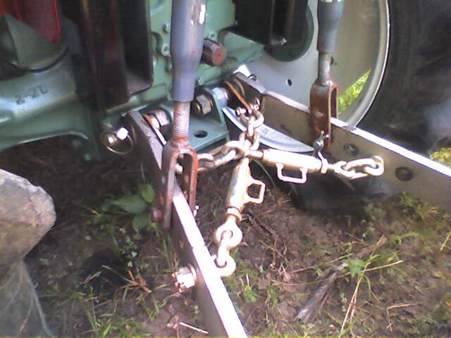

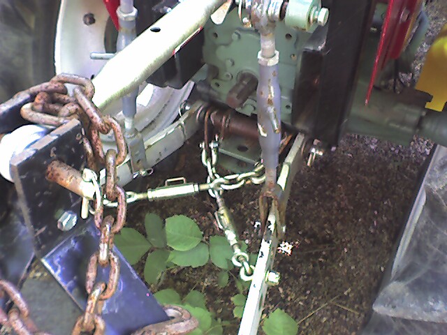

another quick question, do any of you with a similar tractor have a picture of the 3 point attachment points?
i have a 3 point kit, but the lower link arm pins werent included. the differential housing appears to have a hole on each side to accomodate a threaded pin, but the holes dont extend into the actual housing and there are no threads. if i remember correctly i saw a 2010 that had a bracket that held the pins and bolted on using the outer housing bolts. a picture would reallly help at this point.
   / ym1602 #10
Here's my 1602D..........
Oops, here's an updated one, I strengthened it.......
