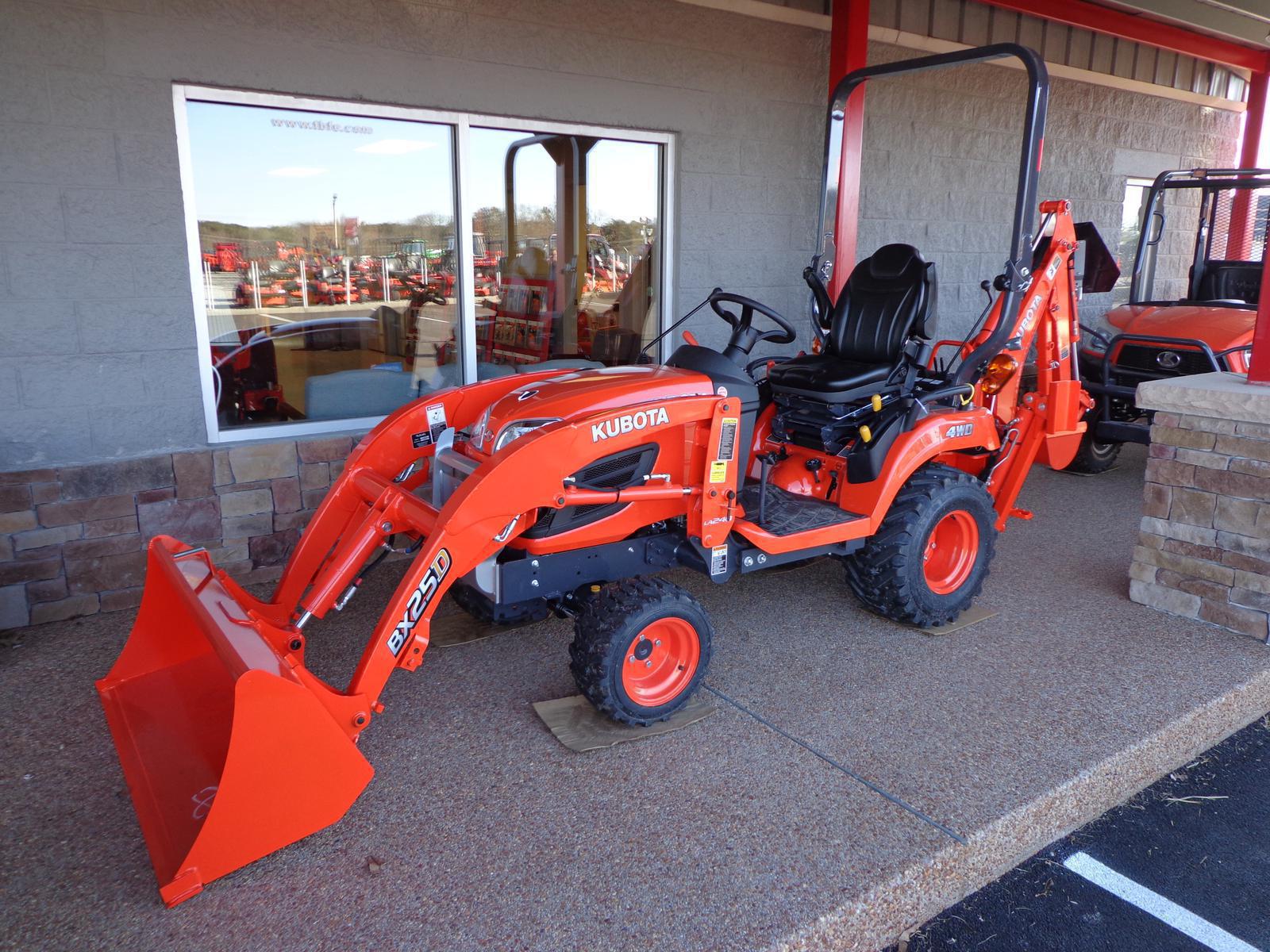

Spend $19000-$20000 on a 2012-2016 BX25D style unit?

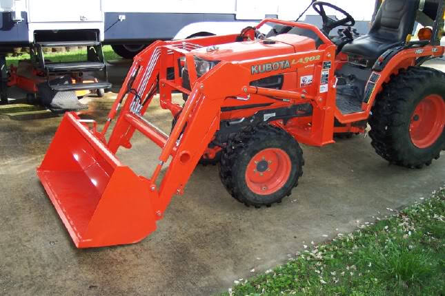

2006 BX2350 1100hrs $9200 (No backhoe, cosmetically it does have some broken and cracked plastic)

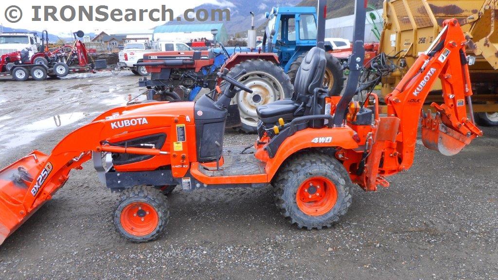

2016 BX25D 58hrs $21000 IRON Search - New & Used Farm Machinery - Tractors - Agricultural Equipment for Sale - By Dealers & Owner

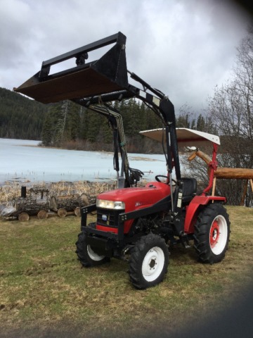

2005 JINMA 284 350hrs $6900 (no backhoe 4WD,2 Speed PTO, 3 Way Bucket)http://www.kijiji.ca/v-farming-equipment/kamloops/2005-jinma-tractor/1258218207?enableSearchNavigationFlag=true

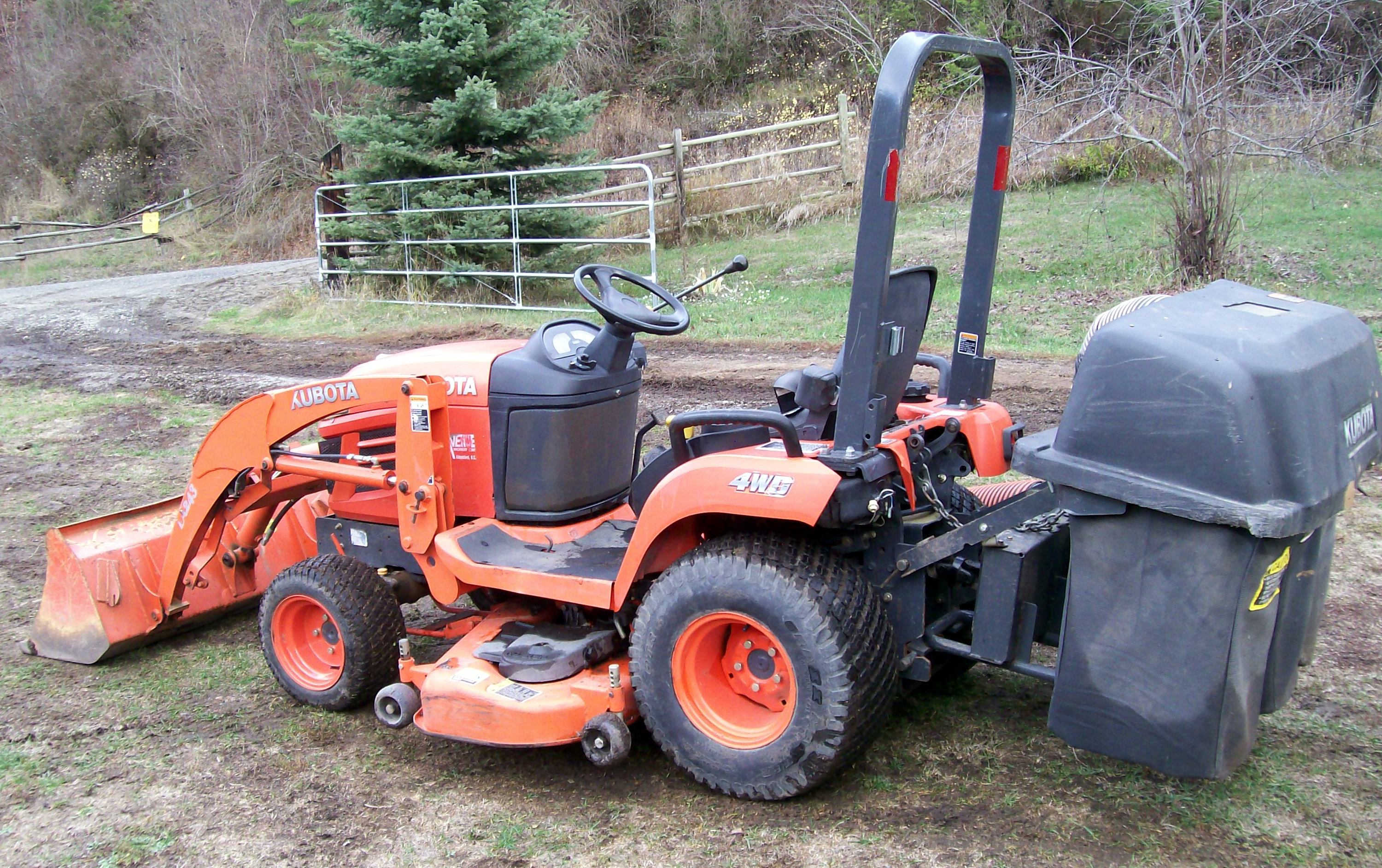

2007 B7510 170hrs $16500 (no backhoe)

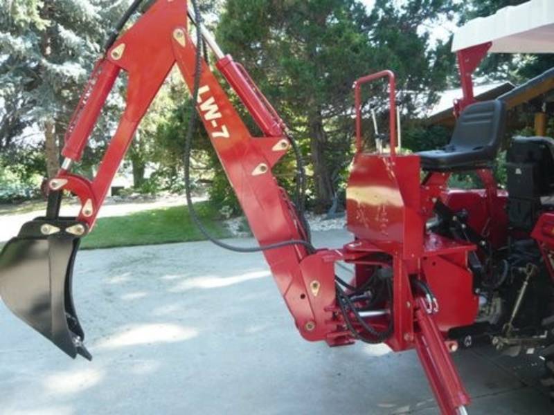

2016 LW-7 backhoe $3500 +tax
This one is my vote. Probably still under factory warranty and might still be able to purchase an extended warranty. You also know what has been done to it. Find out if the 50hr. Service has been done, if not, make the dealer do it as part of the sale. That or buy new for not much more and get the benefits of better financing and the promotional 6 yr powertrain warranty. While I understand you're handy, it sounds like you're ready to get to work rather than troubleshooting a machine.
I think it's worth going with the factory installed BH. No second seat needed. Easy attach and disconnect. No messing with the factory hydraulics to "make it work".
