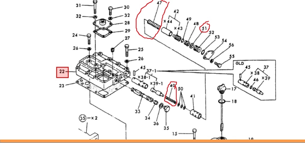

I’m new doing this My 336d is doing the same. Had a new clutch put in a year ago and it was working fine till the other day Ikinda jammed it from reverse into forward. Today I changed filter and hydraulic fluid and still the same. It goes into gear but only when I increase rpm. Bucket hydraulics and power steering are working normally. Ps. I paid 6000 to have the clutch replaced. Thanks for any help. Jay

Not sure you are talking about the power shift clutch packs or the mechanical clutch. $6000 for either seems ridiculous. "If" you are talking about power shift problems I would first look at your relief valve springs in the regulator case. Do you have a parts manual and any kind of service manual? The parts manual is available on line and a 276 service manual is available on line which has trouble shooting section that would likely work for your 336.
The PowerShift clutch packs do not require high pressure like the loader does.
They only need about 225 psi. And revving the engine really does not effect it. It puts out that much pressure at an idle.
The pump for the clutch packs is separate from the pump for the rest of the hydraulics. The pressure for the clutch packs is controlled by the springs Winston mentioned, which are in the Regulator Case on top of the transmission, under a sheet metal guard.
The springs are nos. 40 and 47 in the pic. Sometimes they just get weak and sometimes they break, but replace them both.
No. 51 is a filter screen which the early models had but later ones do not, if yours has one clean it and re-use it.
